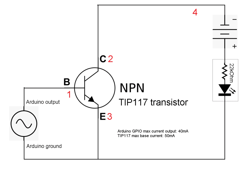

neanderthalphysics said:

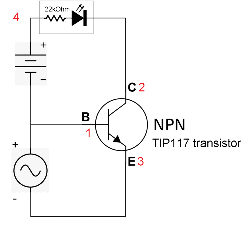

I tried at first driving a NPN transistor directly from the Arduino (emitter - base loop), with the collector-base loop containing the 2x AAA batteries in series to the laser but for some reason it is not powering the laser.
Aiie, there be a problem! The LASER and battery should connect to Collector and Emitter. Negative to Emitter and Positive to Collector.
And maybe another one -- are those AAA batteries perhaps Lithium batteries. A quick web search shows at least some Green LASERs have a threshold volatge around 6V, not the apparent 3V you may be using... but you don't say.
The Emitter should also be connected to the Arduino Ground (Common), and the Arduino output to the Base.
There should also be a series resistor between the Base and the Arduino output to limit Base current. You didn't give a part number so YOU look up the transistor data sheet for the maximum base current and select the resistor accordingly.

Edit: your circuit is incorrect. Laser and batteries must be connected in emitter-collector loop, not collector-base.
Also, 2xAAA may have a problem driving blue lasers with NPN driver. Either add third AAA cell or use MOSFET drivers.

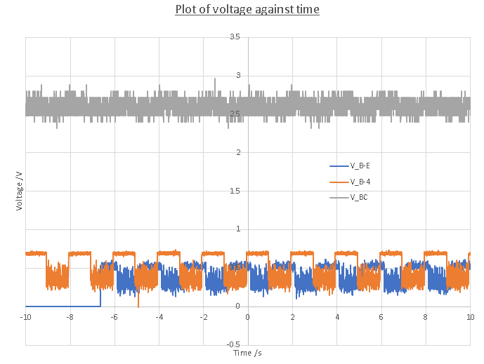

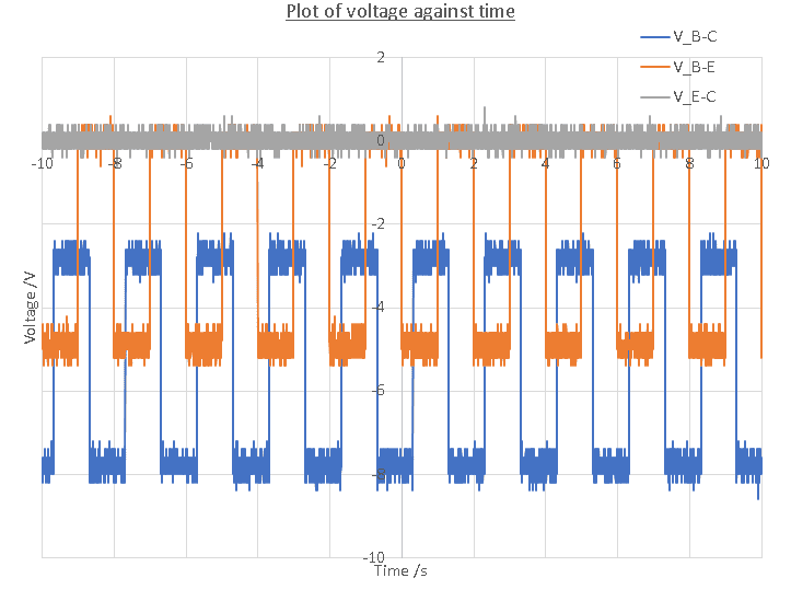

Hi everyone.
Attached are my circuit diagrams and oscilloscope traces. The legend on the graph corresponds to the locations marked in the circuit diagram.
The voltage of the two AAA batteries is 2.74V. By themselves they run the laser pointer fine.
The driving signal is a +5V/0V, 2 second period, square wave.
Will read the latest responses now.
Any other readings/info you need I will be happy to provide.

Thanks guys. How does this circuit look?
I note that the maximum base current of a TIP117 transistor is 50mA, which is more than the maximum current per GPIO of 40mA.

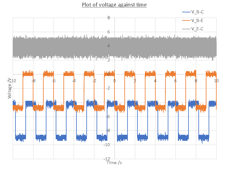

Here are the oscilloscope readings for the circuit with the laser + battery put across the emitter-collector terminals. The laser remains unactivated.

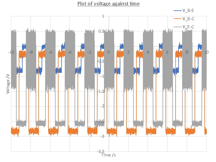

Here are the oscilloscope readings with 3xAAA batteries in series instead of 2. The laser is still inactive.
I tested the laser again with 2x AA batteries directly connected to it. It works.

Hey, it's early and all but isn't the battery in the schematic in #14 upside down? If not it could explain why my stuff never works.
[note added in proof] upside down relative to the transistor. Seems like the laser diode should be flipped around as well.
I thought it is +ve terminal of the battery to +ve terminal of the diode and vice versa?
The current by convention flows from the + terminal to the - terminal of the battery. What has me confused is that the current flow for a saturated NPN is down through the collector and out through the emitter. In your diagram the current is flowing up through the emitter and out the collector.

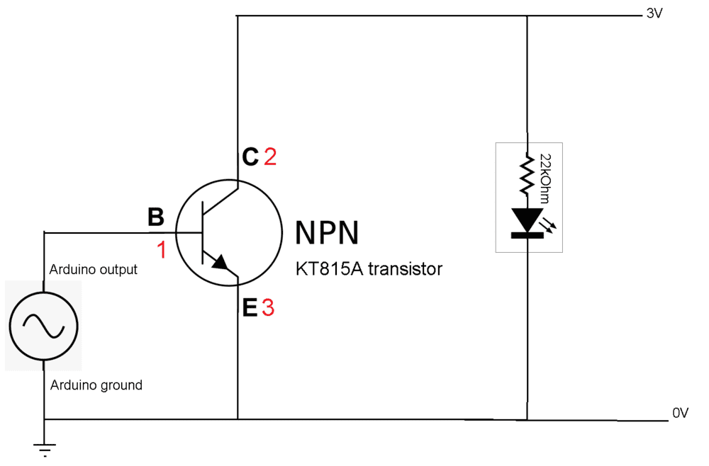

Thank you for your advice.
I implemented the changes you suggested but it is still not working.
you DIDNT change it ... the battery terminals are still incorrect relative to the transistor
I also suggest replacing the laser with a 1k dummy load resistor. The laser is a diode which permits current flow only in one direction so getting it in wrong is a show stopper. Check the voltages across the the resister and make certain the transistor is switching as expected before substituting the laser.

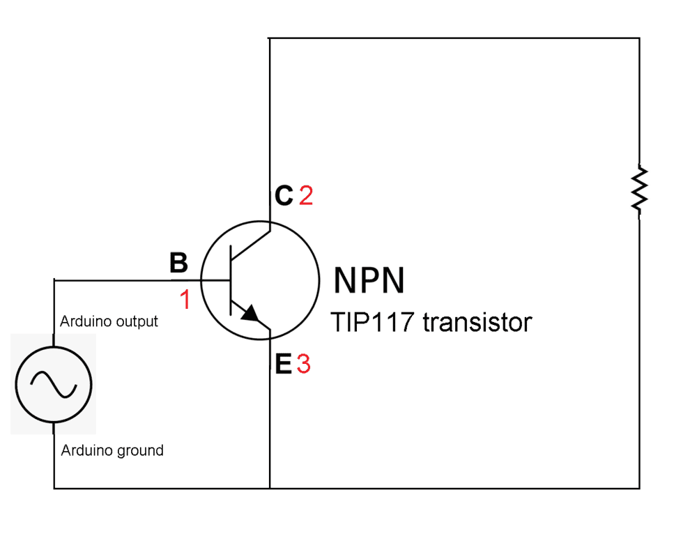

OK thanks for your input.
I replaced the laser diode with a resistor, and the battery with a lab PSU set at 3V.
I am still getting a flatline of voltage across the resistor. The PSU reports no current flowing through it.
Think all my experimentation has killed the transistor?
the battery
What battery ? Don't see none...
Okay, one needs a battery. ##V_{BE}## should be about +0.7V for a silicon NPN for it to be saturated. ##V_{CE}## in this state would be zero should the battery be absent. Your scope trace shows a negative ##V_{BE}##. Signs of voltages and currents really matter here. An NPN is like a current control where a small current, ##I_B##, injected -into- the base results in an ##I_{E}## ##\approx \beta I_{B}## where ##\beta\approx 100##. I think the transistor (any NPN transistor) spec sheet would have all these things plotted and would be helpful for you.

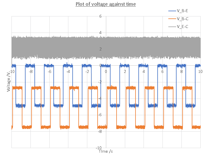

OK guys, got it working :smile:
Thanks for everyone's help.
The problem was the transistor - it was faulty.
Replacing it with another transistor got the circuit to work.
The circuit without the battery with a PSU instead is attached below.

Looks as if it only works because the transistor is abused to short-circuit the "voltage" source (the psu)
Likes rbelli1
  • #31
OK, how would you improve it?
  • #32
How to use a transistor to drive an LED
Your circuit only works because the series impedance of the battery is high. If you put that on a strong enough battery you would instantly explode the transistor.
