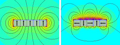

Magnets typically make bad cores for transformers. Can you maybe guess why? :smile:
https://www.kjmagnetics.com/images/blog/normalvshalbach.png

I mean that I want to use Halbach configuration using coils. I'm thinking to arrange solenoid in Halbach array arrangement to give strong flux in one side and weak in the other side. We know that solenoid behave similarly to the permanent magnet. Since alternative current change current in direction, I'm thinking to give pulse DC to solenoid which will give similar result like permanent magnet. Just my idea, kindly advise.

The topology of the Halbach array is quite different to the topology needed for a transformer. A transformer benefits from a reduced magnetic path length with tightly coupled windings. The Halbach topology is more applicable to linear or rotating motors where the magnetic path crosses a gap to a moving armature.
Electromagnets are inefficient when arranged as a Halbach array because of the great length of wire required. The Halbach configuration is more suitable for the fabrication of permanent magnets. Permanent magnets are bad news near transformers as they cause asymmetric saturation, which generates harmonics and reduces the maximum power that can be transferred.

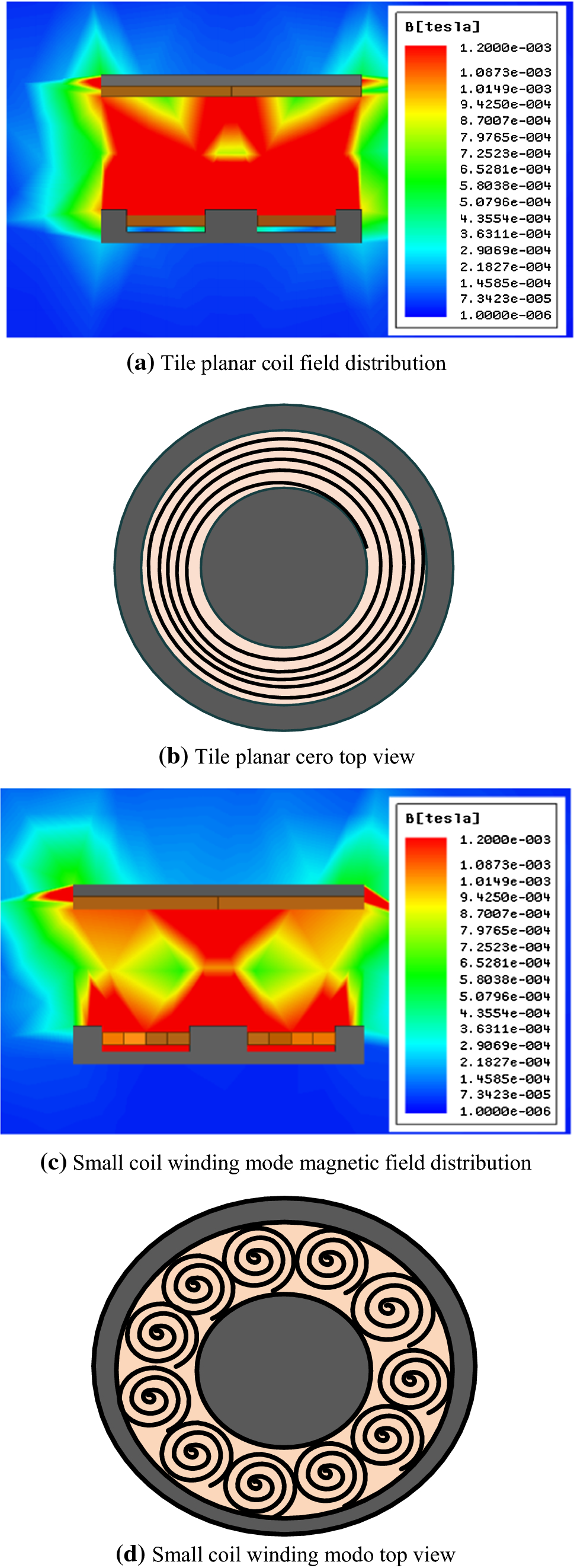

The most important reasons of the low efficiency is the flat design, the air gap and the low voltages involved. The only issue you can address is the former, indeed. But this Halbach thing won't be a help, since the magnetic field is already quite well 'directed', with barely and leakage on the bottom: that half of the pot core does that well.
It is just flat pots are no good pots 😉
This picture from this paper (if you can dig up the full text somewhere) might be a help: at least it can give some directions and keywords to move forward.
