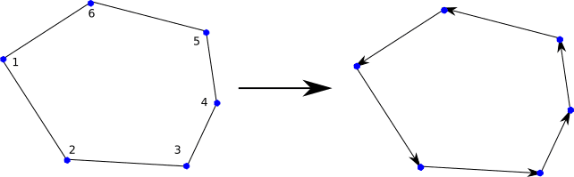

The 2-D counterpart would be a half-edge, which is trivial to traverse as in a Hamiltonian cycle if the graph nodes and edges are the same as the original polygon. All you have to do is follow the half-edges:

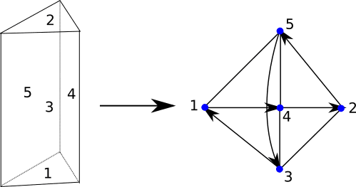

But this doesn't seem to be easy when dealing with faces (or half faces). I don't even know if there will be a hamiltonian path of the faces for every possible polyhedron. And determining those is not easy and hard to keep in memory pre-processed. Here's an example for a prism:

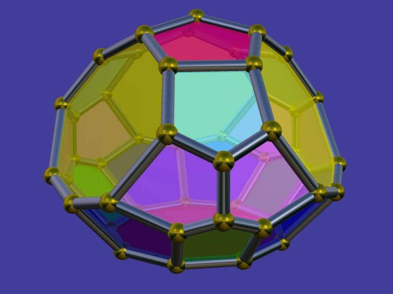

Hi, bit late, but couldn't resist commenting on this. I was interested to see Grinberg's theorem, which I wasn't aware of. The wikipedia page shows an example of a non-Hamiltonian graph, so I wondered what this would look like in 3D as a polyhedron. As it happens I wrote a program called Stella4D which can help with this sort of thing. Here's a picture of the model I came up with.
Likes Estanho

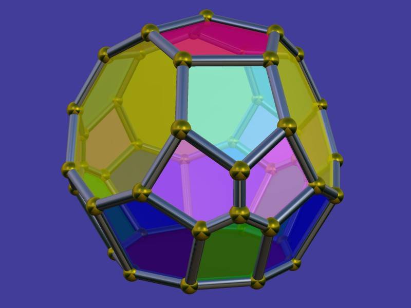

I wrote a program called Stella4D (http://www.software3d.com/Stella.php) for investigating polyhedra and 4D polytopes (it's commercial software FYI). It has a little-known feature to build new polyhedra using a spring-relaxation system, from a description of its topology alone. I used it originally to generate many of Stella's built-in polyhedra, such as the Johnson solids and near misses. You specify all the faces, based on vertex indices (which you assign arbitrarily), which can be a bit tedious, but it's good for things that can't easily be made other ways. In fact I just created a better realisation of the above non-Hamiltonian graph. This one has all regular 9-gons and 8-gons. Only the pentagons remain irregular:

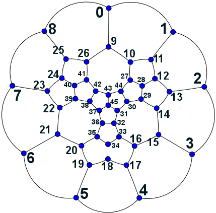

Here's the input I used for Stella4D:
h ~6 (0 1 2 3 4 5 6 7 8)
(9 26 41 42 43 44 27 10)
(21 20 35 36 37 38 39 22)
(15 14 29 30 31 32 33 16)
(0 8 25 26 9) (8 7 23 24 25) (7 6 21 22 23)
(6 5 19 20 21) (5 4 17 18 19) (4 3 15 16 17)
(3 2 13 14 15) (2 1 11 12 13) (1 0 9 10 11)
(25 24 40 41 26) (23 22 39 40 24)
(19 18 34 35 20) (17 16 33 34 18)
(13 12 28 29 14) (11 10 27 28 12)
(40 39 38 42 41) (34 33 32 36 35) (28 27 44 30 29)
(45 43 42 38 37) (45 37 36 32 31) (45 31 30 44 43)
The "h" means the model is convex, so an initial parse is done where extra springs are used to expand the graph like a balloon.
The "~6" means that all faces with 6 or less sides are irregular, so in this case the 8- and 9-gons are made regular.
Each face is define inside parentheses. The vertex indices can be seen below:
Stella4D can also print out unfolded nets to cut out and glue together, so I might make one in paper. It's an interesting polyhedron.
Oh, and Stella4D was written in C++ using OpenGL for graphics.
