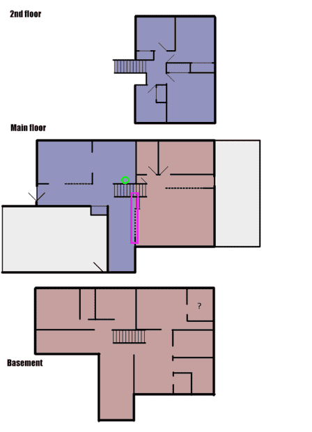

What are my options for balancing the A/C in my 3-level backsplit house?
Been in my new house for a month now.
  • It's an n-level backsplit (value of n depends on whom you ask)
  • It has central air heating/AC.
  • There are two families: my wife and I are in the lower flat (red) and our boy and his fam are in the upper flat (blue).
  • Upon closing we had a wall (with door) put in between their flat and ours, (magenta) which was heretofore open.
  • It came with a NEST controller (green) located in their dining room.
  • I do not know if there are any (other?) thermostats in the house.
The problem:
It is too warm up on the top floor, it is optimal on their main floor.
It is too cool on our main floor and it is (naturally) cold in the basement.
Now, that a bit tricky, since we sleep on our main floor, and it's got to be cool.
I don't really know how these Nest things work. You can buy thermostats as separate units and distribute them about the house.
I don't know if the controller itself also acts as a thermostat. So I don't know if there should be at least one thermostat somewhere in the house. We have not found any. It would not surprise me if the previous owners tossed them in a box while packing. Do I need to have at least one? Should I get another?
My boy is talking about a booster (which has nothing to do with the Nest technology). It sounds like it's just a fan to help the air reach farther rooms.Help?
Location of air handler unit(s)?
It seems that the magenta new wall has blocked the free return of the suplied air back to the air handler unit.

I'm not sure of your HVAC setup, but I doubt it's the thermostat that's the problem. Unless you have individual control of different HVAC circuits, one thermostat can't do it. Even if the controller(s) could say heat the lower level but not the upper level, or vice-versa, could your HVAC system do that? All one thermostat can do is set a good average temperature.
Normally there is some relatively fixed ratio of flow between different rooms controlled by dampers (valves) or register vents. That may need to be addressed. Why not hire an HVAC guy to come in and make some suggestions or adjustments?
Likes russ_watters and DaveC426913

Your question suggests that you will need assistance from an AC company in evaluating and remediating the air distribution problem that you have.
They will probably need to install a transfer duct that solves the interference to the path of air that the new wall has created (especially if the top end of the stairs to the basement is on your side of the house).
They can also do a test and balance of all the diffusers and grilles in the house in order to achieve a better air distribution via the central duct system.
If all that fails, they can install duct automatic dampers controlled by thermostats located at the four main zones and/or duct booster fans where needed.

It may help a lot if you check the comfortable temperatures for every area first, since it may differ depending on external circumstances (with different wording: you may feel the same air temperature hot or cold depending on external circumstances).
Can you mark on the drawing the location of all supply and return grilles? More pointedly; is there one return in each room or just a single big one in the basement by the big contraption with the air ducts air handler?
This is no doubt a balancing (where the air is going) problem that may have been caused/exacerbated by putting in the wall.
You may just need to close supply grilles where it is cold. ...and may also need a transfer duct/grille.
You have one ac unit so one thermostat. That isn't a problem.

I've heard of cases where the builder didn't put in return ducts where they should have. You need a thermostat in the upper floors that determines when the AC unit runs, and you need one in the lower floors to determine when/if to open a duct to the lower floors. In the winter it will be opposite. In the mean time go to the thermostat and set it so the fan goes full time. The booster may be necessary. The lowest floor will always be too cold unless you have heat available. Is it noticeably different if you leave the door open? I would guess not. I have a 2-level house with a door at the bottom of the stairs. It doesn't make a lot of difference. I use an electric heater in the room I am in often downstairs.

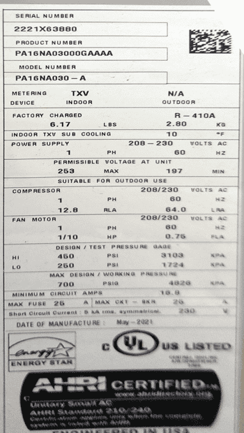

Including garage? That's really big to only have one HVAC system. Do you happen to know the capacity? It's probably in the model number on the sticker on the outdoor unit (condensing unit).
Not including garage. But it is including finished basement (which might not have been in the specs when the system went in).
I'll check the capacity.
Can you deduce anything from this?
  • #32
030 in the model number means 30,000 BTU or 2.5 Tons. It's about half the capacity I expected. By comparison I'm in Philadelphia and my 1,500 sq ft townhouse has a 2.5 Ton unit.
Are there areas of the house with no supply vents? You only have one of those outdoor big fan cube thingies condensing units, right?
  • #33
I'm about twice as far north?
I don't think so. Would a basement normally have vents?
Yes.
