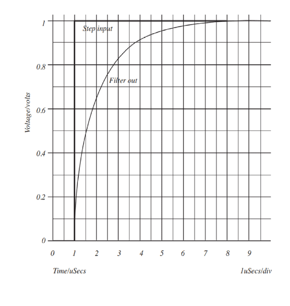

Estimate the half-power cut-off frequency of the filter and sketch its
frequency and phase response.
Equation used if i am correct.
Tr = 0.35/Bandwidth
I have been given the attached following question:
FIGURE 2 shows the response of a first-order filter to a step input. Estimate the half-power cut-off frequency of the filter and sketch its frequency and phase response.
I believe that I have correctly calculated the half-power cut-off frequency as 127.27Khz. However, I am not sure how to begin sketch the frequency and phase response.

What would a simple RC lowpass filter look like to generate this time domain response?
If you sketch that RC lowpass filter and write the transfer function ##\frac{V_o}{V_i}## using complex impedances, can you then plot the frequency domain magnitude and phase response?

How did you arrive at f=127,27 kHz?
Yeah, I get slightly higher than that, based on the graph and his Relevant Equation...
Likes osilmag
OK, but what about τ=RC=1/2πfg with τ=1µs at v(t)=0.63*Vmax?
Both results differ considerably. I suppose, the graph is not correct.

I believe the graph was given as part of the problem statement, no? And I think the OP was asked to calculate ##\tau## from the graph, so when the rising waveform makes it to ##1 - \frac{1}{e}##
Yes - but there are two basic methods to find the 3dB-cut-off from the 1st-order step response :
a) based on the rise time (10% to 90%)
b) based on the 63% criterion (identical to the slope criterion for t=0).
The problem ist that the results differ considerably.
Therefore, I assume that the shown graph is not the correct step response for a 1st-order system.
(For example, the curve crosses the maximum voltage at 8µsec.)

In my experience, practicing EEs always use the 10-90% definition of rise time, unless they've said otherwise. Physicists and mathematicians do whichever they like.
Yeah, good points by both of you. I guess we need to figure out where that rule of thumb of ##\frac{0.35}{t_R}## comes from, and which standard for rise time they used
It's from 10-90% step response of a single pole.
Link? (I'm in a Teams meeting so have not been able to do the search that I wanted...). Thanks Dave.
Or math. It also comes from that.
a single pole unit step response is ##f(t) = 1-e^{-\frac{t}{\tau}}## Solve for t gives ##t=- \tau \ln{(1-f(t))}##
So the 10-90% rise time ##t_r=- \tau (\ln{(1-0.9)} - \ln{(1-0.1)}) = \tau \ln{(9)} = 2.20 \tau##
But ##\tau = \frac{1}{2 \pi f_o}## so ##f_o = \frac{ln{(9)}}{2 \pi t_r} = \frac{0.35}{t_r}##

The method I used was:
0.35/tr with when tr is 90-10 of the final value.
