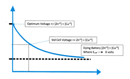

The sustained discharge of a Voltaic Cell is due to separation of the oxidation and reduction processes called a controlled Galvanic Process that can sustain a charge flow over a long period of time. In contrast, an uncontrolled Galvanic Process would be like dropping a zinc bar into a solution of Cu+2ions and allowing the redox process to proceed until it naturally stops due to the Cuo(s) coating on the zinc bar surface preventing further oxidation of the Zn to Zn+2.
In a controlled Galvanic process, the change in voltage (Δv) as a function of time would follow an exponential decay trend like a 1st order decay process and is dependent on the ion concentration ratios at specified times. That's the log (A/C) term at the end of the Nernst Equation. The following graphic illustrates such a trend for a Galvanic Cell like the Zn/Cu cell system.
241338
Such explains the need for a high Cu+2 ion concentration at the cathodic cell and a low concentration of Zn+2 ions at the anodic cell in order to optimize the net cell voltage at the ‘beginning’ of discharge (i.e.; new battery). As time passes, the Zn+2 ion concentration increases with oxidation of the anodic metal and Cu+2 ion concentration decreases with reduction to standard state Cuo(s) from the cathodic cell solution. The concentration of ions will momentarily be equal and the net cell voltage is equal to the standard cell voltage. Beyond this, the Zn+2 ion concentration continues to increase and Cu+2 ion concentration decreases until the anodic Zno(s) metal is consumed by the oxidation process and the net cell voltage reaches zero, dead battery.
So, simply changing the electrolyte to a strong acid in the anodic cell wouldn't necessarily increase voltage, but might increase the oxidation rate of the metal and result in a faster battery discharge rate and dead battery sooner that if a common ion solution were used.
This makes a lot more sense now! I now understand how voltage would be at highest when the reaction first begins, given (as you mentioned) the ideal conditions of high Cu2+(aq) and Zn(s).
