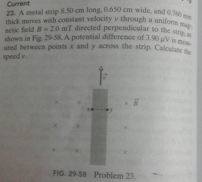

A metal strip 8.5cm long,0.65 cm wide,0.76 mm thick moves with constant velocity v through a uniform magnetic field B=0.2mT directed perpendicular to the strip,as shown in figure.A potential difference of 3.9 microV is measured between points x and y across the strip.Calculate the speed v.

The situation in this problem is not the same as the situation for the Hall effect. In this problem, there is no electric current being driven along the length of the strip and the strip is moving through the B field. In the Hall effect, you have the opposite: there is an electric current and the strip is not moving through the B field.
You do not need to be familiar with the Hall effect to answer this question.
The strip is a metal. Think about what the magnetic field does to the free charge carriers in the metal.

The B field exerts a force on the electrons causing them to move towards the "y" side of the strip,which I believe is the reason for the difference in potential between x and y,but then how does all this make the entire strip move FORWARD??
The motion of the strip is not due to the magnetic field. The question wants you to assume that the strip is moving with constant velocity. The motion of the strip could be due to some external agent (although once the strip is moving with constant speed, a force would not be required to keep it moving). So, don't worry about why the strip is moving.

When the strip first starts moving with speed v, electrons move toward the right side and a potential difference develops between the left and right sides. Does this potential difference continue to increase as long as the strip is moving at constant speed, or does the potential difference attain a constant value?
What prevents the potential difference from continually increasing?
It attains a constant value(enough to create an electric field which cancels the magnetic field).
The electric field doesn't cancel the magnetic field. But the electric force cancels the magnetic force. Use this to determine the electric field.
Likes Tanishq Nandan
Of course!
E=V/d
qE=Bqv
q gets cancelled..E can be determined,B is known,you got v.
Thanks..
Yes, very good.
