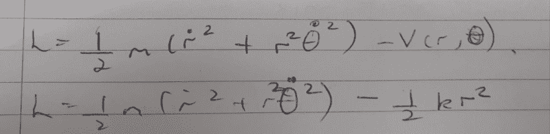

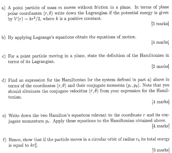

Find the Hamiltonian of a Point particle on a frictionless plane with a given potential (kr^2)/2
L = T - V
dot rep time derivative
L = (m/2) * ( rdot^2 + r ^2 θdot^2) - V (r,θ)
Lagrange eq
d/dt (∂L/∂xdot) = ∂L/∂x
H = Σ pi qdoti - L

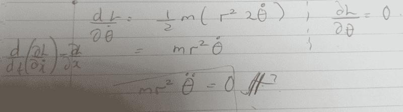

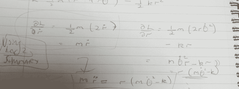

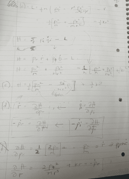

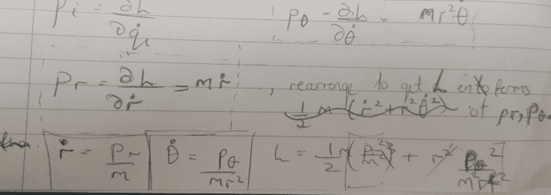

I am stuck on Question e and then how to proceed to f. I cannot seem to show this using the steps in the prior questions. My answers are:
a)
b)
c)
c) continued - and d) at the bottom of the page
d)
I am not sure where I have gone wrong, as I am not sure how to apply the relevant Hamilton's eq to the Hamiltonian in e)
I can sub in p_r into the Hamiltonian in e) however, I cannot use the p_theta 'dot' expression.
and then also
for f) how to show the energy is equal to kr_0.

I agree with your Hamiltonian Expression, to complete the problem (the last few parts) realize that ##\dot{r} = 0## if we're talking about circular orbit ##r = r_0##. Which from the EL equation involving ##r## should tell you ##p_r = 0## (Which in turn tells you ##\dot{p_r} = 0##) (THIS IS THE KEY PART)
This cancels out a term in your Hamiltonian leaving.
## H = \frac{p_\theta^2}{2mr^2} + \frac{kr^2}{2}##
Take the expression for ##H## and find ##\dot{p_r} = - \frac{\partial H}{\partial R} ## set it equal to ##0## and solve for ##\frac{p_\theta^2}{2mr^2}## and plug it back into ##H## your answer should pop out.
Your assignment is likely turned in by now but you may find this helpful anyway.
But yes, use Latex next time, It is awesome.
