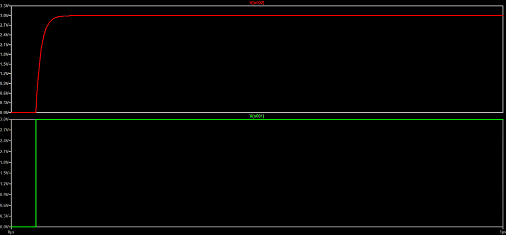

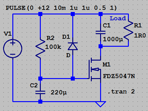

You might consider an N-channel MOSFET in the negative supply rail. Use an RC LP filter on the gate so it turns on slowly.

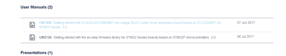

have you read the ST provided info PDF's?
Here is the application and setup of the board with explanations of jumpers and pin settings etc.
https://www.st.com/en/ecosystems/x-nucleo-ihm08m1.html#Take a look at the first PDF's namely, product specification and user manual
