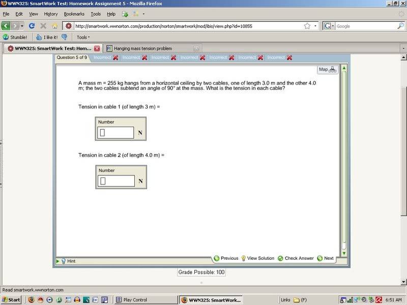

A mass (m=255kg) hangs from a horizontal ceiling by two cables, one of length 3m and the other 4m. The two cables subtend an angle of 90 degrees at the mass. What is the tension in each cable?
F=ma
T=ma?
It's in equilibrium, so the forces sum to zero. F=ma so, 255kg(9.81)? or 255kg(-9.81)? I am confused about the word subtend? I know a chord in a circle subtends the arc... but here..? The lengths of the cables are confusing me, how can the ceiling be horizontal, and the cables make 90 degree angles with the mass, but be different lengths? So I must be interpreting the information wrong and making it harder then it is. Ah!

I have interpreted it as in the image below:
http://img519.imageshack.us/img519/7097/subtendyd7.png
So use trigonometry to calculate the two angles that meet the ceiling.
Then you can create a simultaneous equation. You are correct that it's in equilibrium so sum of forces = 0
Using this, let A = tension in rope of length 3, and B = tension in rope of length 4
Acos(z) - Bcos(x) = 0 (1)
where z is the angle A makes with the roof and x is the angle B makes with the roof.
Also, the weight of the mass creates a force of F = mg
therefore Asin(z) + Bsin(x) = -mg (2)
The positive and negative sign of mg does not matter, as long as the two equal forces have opposite signs such that the sum of all forces = 0.
Solve the two simultaneous equations (1) and (2) for A and B and voila!

A and B are the tensions of cables length 3 and 4 but I did something wrong. Did I approach this completely backwards or what? I think I'm making it more difficult then it is.

Read over my instructions again. You forgot some sines and cosines
cos(z) does not equal 53 degrees. z = 53 degrees.
same with cos(x).
so Acos(53) - Bcos(37) = 0
that's your first equation.

I can't see why you think you've done something wrong. I solved the equation just then and got the tension in the 3m rope to be 1997N and in the 4m rope to be 1505N. These are of the same order of your answers, so some simple significant figures could change a lot.
