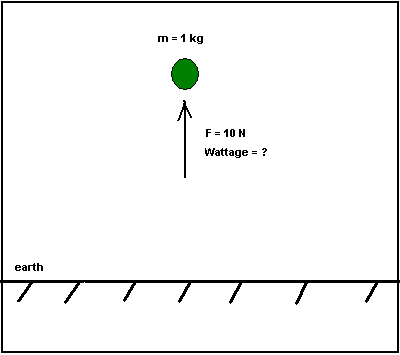

Vigant
We want an object to hang in some height.
The mass is 1 kg so we need a force of 10 Newton to keep the object in the place.
I cannot find what wattage we need for this. (Say we use a rocket motor to produce the force.)
To keep the object stationary you do not need to do any work at all. (Did you ever see a bookshelf with an internal engine?)
So when I place a bookshelf 10 meters above ground, it will stay there forever?
You are reading but not understanding. Nobody said anything about placing the bookshelf above the ground. I am talking about placing an object on the bookshelf and the bookshelf will happily support the object without an energy source.
The point is that you need force, not energy to keep something up. Whether or not you need to spend energy to provide that force is a matter of how the force is generated, not of the object being held. Therefore your question is ill defined.
If you use a rocket motor with a small mass flow rate and a high exhaust velocity it can take an extremely large amount of power. In the limit, it would be like trying to support the object with the thrust from a flashlight. The flashlight has to be very VERY bright and draws a fiendishly large amount of power.
If you use a rocket motor with a large mass flow rate and a small exhaust velocity, it can take an extremely low amount of energy. In the limit, the exhaust velocity goes to zero, the mass flow rate goes to infinity and the required power goes to zero. Of course, now you have to worry about supporting the reaction mass as well. So that approach can't go very far.
But what if the reaction mass were supplied externally... That is the working principle behind a helicopter. In principle, with big enough, strong enough and light enough blades, it takes negligible energy to support the weight this way.

Vigant said:
The potential energy of the object does not change there ( as d=0 and v=0).
Still we need some power to keep the object on the place.
No, we don't. We can support it without power (put it on a table, hang it from the ceiling).
If we choose to support it with some engine, then it will depend on the engine how much power it uses.

Vigant said:
relationship between the force we need and the engine power
The relationship is between force, engine power and relative velocity of whatever the mechanism is pushing against. There is an exact relationship there.
Consider a helicopter. The forces on the blades can be resolved into the wanted vertical force (lift) and the unwanted horizontal force (drag). The lift component acts at 90 degrees to the motion of the blades so the work done producing lift is zero. However the drag force is in the direction of motion so power is required to overcome it.
If the helicopter was "ideal" the blades would have no drag or any other losses and the power required to hover would be zero. Unfortunately there is no such thing as an ideal helicopter.
