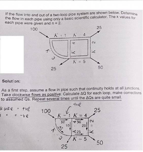

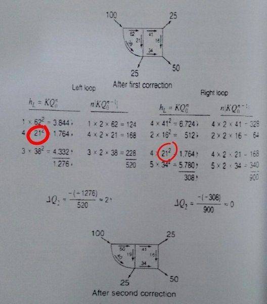

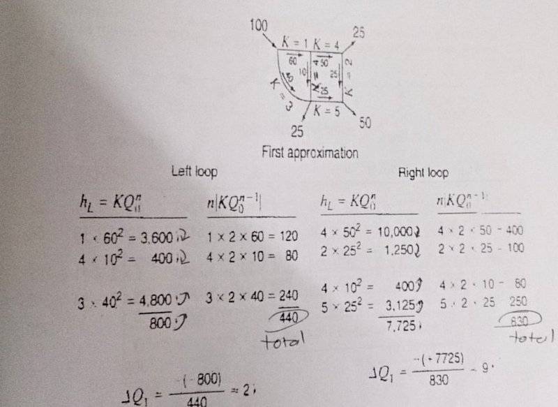

I have problem with the flow rate (Q) in junction that join 2 loops together , where k = 4 ,
Why in the second correction , the corrected Q in first and second loop = 21 clcockwise for left loop , and for 21 anticlockiwise for right loop ?
IMO, it should be 10+2 = 12 for the left loop , and for the right loop , it should be -10-9= -19 , am I right ?[/B]
