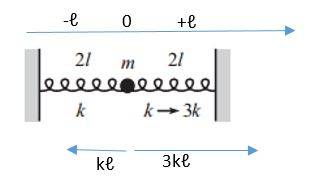

a.
Drawing the forces:
$$ 3kℓ - kℓ = m \ddot{x} $$
$$ 2kℓ = m \ddot{x} $$
But from this equation I don't get the result given in the question.
Any hint will be great :)

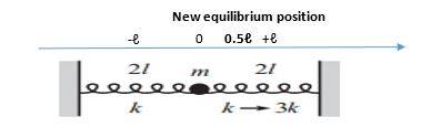

b. The equilibrium position is where the forces on the mass is 0, meaning that both of the spring forces deleting each other, but I'm not sure how to determine it.
I tried to describe the forces according to the displacement for every spring:
Left spring: -k(ℓ+x)
Right spring: 3k(ℓ-x)
But I'm not sure how to use/solve the equation:
3k(ℓ-x) = k(ℓ+x)
2kℓ = 4kx
x= 0.5ℓ
I'm not sure if my way is correct.

In (a), you are asked about subsequent motion. The extension l is only the initial state. When the displacement is x, what will the tensions in the springs be? (My inclination would be to solve b first, then use that as the x=0 for part d, then deduce a.)
Your solution to b is correct.
I think you are only supposed to consider motion in the x direction.
I tried to solve using the new equilibrium position combining with the equations:
The new equilibrium position is x= 0.5ℓ
Therefor the Amplitude is $$ A=0.5ℓ $$
Solving
$$ \dot{x}(0)= 0 $$
$$ \dot{x}(0)= 0.5ℓ \omega cos(\phi) = 0$$
$$ \phi = 0 $$
The forces in the x(0)
$$ 2kℓ = m \ddot{x}(0) $$
$$ \ddot{x}(0) = 2kℓ/m $$
$$ \ddot{x}(0) = a= − 0.5ℓ ω^2cos(ωt+ϕ) $$
$$ 2kℓ/m = − 0.5ℓ ω^2cos(0) $$
$$ ω^2 = 4k/m $$
$$ ω = 2 \sqrt{k/m} $$
Therefore
$$ x(t)= 0.5ℓ cos(2 \sqrt{k/m}*t) $$
Does is make sense ?

Looking at your final equation, where is the equilibrium? Where should it be for x?
Likes Lito
Corresponding with the initial x, the new equilibrium position is x=0.5ℓ.
Yes, but is that what your final equation in post #3 says? What, according to that equation, is the range of x?
ohh i miss the displacement ? The spring should range from 0 to ℓ therefore:
$$ x(t)= 0.5ℓ - 0.5ℓ cos(2 \sqrt{k/m}*t) $$
Yes.
Likes Lito
