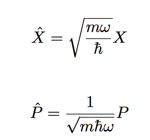

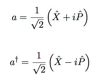

Consider a linear harmonic oscillator with the solution defined by the ladder operators a and a. Use the number basis |n⟩ to do the following.
a) Construct a linear combination of |0⟩ and |1⟩ to form a state |ψ⟩ such that ⟨ψ|X|ψ⟩ is as large as
possible.
b) Suppose that the oscillator is in the state constructed in a) at time t = 0. Write an expression to describe the time dependence of this state state for t > 0. Evaluate the expectation value ⟨ψ(t)|X|ψ(t)⟩ as a function of time for t > 0.
c) Defining (∆x)2 = ⟨ψ(t)|X2|ψ(t)⟩ − ⟨ψ(t)|X|ψ(t)⟩2. Calculate (∆x)2.
I have a hunch that for part a) I need to consider some |ψ⟩ = A|0⟩ + B|1⟩, then differentiate the expression ⟨ψ|X|ψ⟩. However I'm not sure how to implement that, any hints?

Why not just go ahead and calculate <X> for arbitrary ##A, B## as your hunch suggests?
Thanks for the reply.
Ok so I substituted |ψ⟩ = A|0⟩ + B|1⟩ into ⟨ψ|X|ψ⟩, and from simple manipulation I have:
<X> = A*A⟨0|X|0⟩ + A*B⟨0|X|1⟩ + B*A ⟨1|X|0⟩ + B*B ⟨1|X|1⟩
Is this correct? I wonder what can be done to simplify it, should I substitute X in terms of a and a†?

Yes, it's correct. You need to know (or calculate) ##<0|X|0>## and ##<1|X|1>##. You have to calculate ##<0|X|1>## as well. The other term is related to this (hint: think about complex numbers).
You can use the ladder operator or just integrate (if you have a list of standard Gaussian type integrals).
