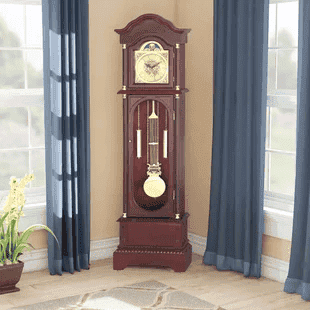

I am thinking of a grandfather clock, for example. I was thinking that the pendulum should take the same time T to complete one complete oscillation, no matter which length l the pendulum has. If the pendulum was shortened then the pendulum will swing faster from one max to another and if it is longer then it will swing slower (amplitudes A stays the same in both cases). This is how I understand the HO.
But, the formula of the simple pendulum implies that T changes if the length is changed. This does not make sense to me...
Note that the period for the pendulum is independent of the angle ##\theta## just as the period for the HO is independent of the linear displacement ##x##. The angle ##\theta## is independent of ##\ell##, this you must realize.
Thus, the periods are independent of the amplitude. (as long as you can use the small angle appriximation for the pendulum)
Changing ##\ell## means basically changing ##mg/k## in the HO. The longer pendulum you have, the longer period T.
But, for a fixed ##\ell##, you can release the pendulum from any starting angle (amplitude) and you get the same period, again as long as you can use the small angle appriximation for the pendulum.

Test out yourself. All pendulum clocks have an adjustment nut at the bottom of the pendulum. If the clock is to fast or to slow, turn the nut.
Simpler still just swing a mass on a string try it with 10 cm length, then 100 cm length.

What is the typical amplitude of a grandfather clock?
idk 5 degrees?
Grandfather clocks also have a mechanism for "brining back" energy into the system (anchor escapement). So one can not treat a grandfather pendulum as a simple pendulum really.
Likes vanhees71
malawi_glenn said:
idk 10 degrees?

The pendulum amplitude must be regulated to maintain a regular natural frequency. That is usually done by the dimensions of the escapement, but then the energy balance is made up at the extremes of the pendulum swing, when the velocity is near zero. In order to not influence the period, the energy losses must be made-up at the zero crossings of the pendulum. Regulation of the amplitude by an escapement, while replacement of the lost energy by the same escapement, are therefore at odds, which makes every mechanical pendulum clock a compromise. For a pendulum to have a regular period, the amplitude can be sensed optically, and the missing energy replaced electromagnetically, one quarter of a cycle later, as the pendulum passes vertical. When compared to GPS time, the rate of the pendulum should then show variation due to the lunar and solar tides.
Likes hutchphd and PeroK
Clock escapements existed long before electromagnets.
In the text below, I bolded the portion that deals with energy replacement. The replacement occurs near the bottom of the swing, not the extremes.
The deadbeat escapement has two faces to the pallets, a 'locking' or 'dead' face, with a curved surface concentric with the axis on which the anchor rotates, and a sloping 'impulse' face.[3] When an escape wheel tooth is resting against one of the dead faces, its force is directed through the anchor's pivot axis, so it gives no impulse to the pendulum, allowing it to swing freely. When the pallet on the other side releases the escape wheel, a tooth lands on this "dead" face first, and remains resting against it for most of the pendulum's outward swing and return. For this period the escape wheel is "locked" and unable to turn. Near the bottom of the pendulum's swing the tooth slides off the dead face onto the slanted 'impulse' face of the pallet, allowing the escape wheel to turn and give the pendulum a push, before dropping off the pallet. It is still a frictional rest escapement because the sliding of the escape tooth on the dead face adds friction to the pendulum's swing, but it has less friction than the recoil escapement because there is no recoil force.

I wasn't aware these are still made. Thanks.
