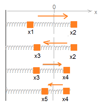

Spring with spring constant k=2000N/m has an object with mass 10kg attached to it. When it is pulled 0.1m away from the equilibrium state it starts oscillating and came to a stop. The coefficient of kinetic friction is 0.2 and the coefficient of static friction is 0.5. Find the time the object took to come to a stop and where it came to a stop.
##F=-kx##
##F=μmg##
##\frac{1}{2}kx_n^2=\frac{1}{2}kx_{n+1}^2+f_kx_n+f_kx_{n+1}##
This is the formula that I took by denoting the nth amplitude (because the amplitude keeps on decreasing) and ##mw^2x=kx-20## solving this gets me the period T but my friend says period T is ##2π\sqrt{m/k}## regardless as to whether the friction exists or not. Which is correct?

When the block is at the maximum displacement it needs acceleration higher than the maximum of static friction force. The objects stops when the force from Hooke's law is smaller thatn this maximum of static friction force. I found out that after 5 movements (here a movement is when the object moves from one maximum displacement to the equilibrium state) the force is smaller than MSFF.
How did you get it?
The object stops at an extreme position, when its velocity is zero. Those 5 "movements" mean that the object stops at the equilibrium position which can not be true, as it has maximum speed there.
No the five movements, since the objects starts from an extreme position, gets the object to stop at an extreme position.
Do you mean the five movements as shown in the figure?
The object starts from position x1, and reaches x2. It turns there, and reaches x3, and so on. |xi+1|<|xi| , by how much? At what position does the object stop? How long does it move?
The object stops at point ##x_5## and moves 2T seconds. (##T=2π\frac{\sqrt{m}}{\sqrt{k}}##)
That is correct.
Why doesn't the period change from the formula ##T=2π\frac{\sqrt{m}}{\sqrt{k}}##
shouldn't it change since friction is now on the line of forces acting on the object?
A constant force does not change the angular frequency. Think of a suspended spring with a weight attached to it. The force of friction is the same during the motion, μmg, only its direction changes, always opposite to the velocity. The object moves from x1 to x2 , x2 to x3, ... according to the formula x=Acos(wt) +B, with w= √(k/m). But the motion is not periodic, as A and B changes from one stage to the other. At each extreme, wt is integer number of pi, therefore the time between two consecutive extremes is always the same.
