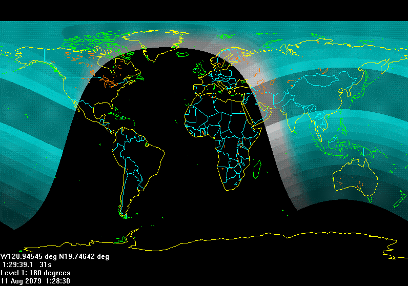

Definitely. These events are only visible over part of the Earth's surface. For example the site linked in Post #5 has a map of the 2079 event. I'm not sure exactly how to interpret the map, but I think the gray region is where it will be visible.
I think that black means you are on the wrong side of the planet. The blue shades tell you the overlap when you are on the right side. The flare near the edge of the black bit is where you need to be to actually see it - while the Sun is still below the horizon. Everywhere outside that flare, you could see if you observed in a wavelength where the sky isn't bright.
That matches up with the commentary that says you need to be near 50°E to see it.

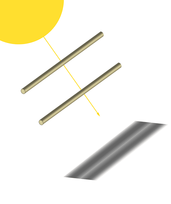

The blue gradient is interesting. It's shown getting lighter and then at full eclipse it's shown darker.
That might not mean anything, but I find it reminiscent of the overlapping shadows of two tree branches. The combined shadow is actually lighter at the centre than next to the centre, like this:
4 4 3 2 1 2 1 2 3 4 4
I wish I could find a pic to show this.
Likewise, the brightness of near occultation will be brighter than full occultation.

It's caused by the fact that a double disc is brighter than a single disc - more area.
There's a weird phenomena you can witness outside under a tree. If you spot two branches in alignment with the sun (so that one branch eclipses the other) the shadow will be complex. Instead of one shadow trough, it will have two, with a low peak between them.
