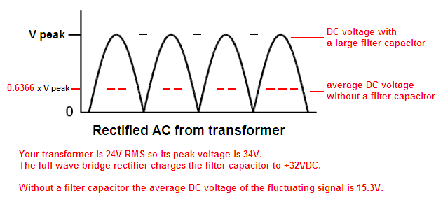

There's two main reasons I can think of that would affect your motor:
  1. The output voltage of a rectified signal is not a flat DC voltage, it is actually just a sin wave except the negative part of the wave is reversed to be positive. The average voltage of this wave is lower than your RMS voltage. This picture represents that well (taken from isaac42's post on HarmonyCentral Forums). Just pretend the 24V RMS is your 14V and the ratio of 24V to 15.3V still stands.:
    Source: http://www.harmonycentral.com/forum/forum/Forums_General/acapella-94/293518-
  2. There is a voltage drop across diodes, usually about 0.7 V. This will also reduce your effective DC voltage.

If your 14V regulator is for battery charging it will be regulating the peak AC, not the RMS
To use a capacitor instead of a battery;
An 80W fan on 12V will draw a current of 80W/12V = 6.67A
What is the frequency of the AC? If 100Hz then period T = 10msec.
C = I * T / dV; For a 1.0V droop in the capacitor during the cycle;
C needed will be C= 6.67A * 0.01sec / 1.0V = 0.0667F = 66.7mF, rated at 15V or better.
Maybe buy ten x 10,000 uF capacitors. US$2 each.
Wire them in parallel to give 0.1F that will handle the current at the stator output voltage peaks.

In Kavik's sketch above, the regulator would chop off the wave as required to maintain battery voltage about 14.5 .
With no battery present to absorb current i'd be at a loss to predict how your regulator would work. It'd probably chop the wave early which would give you lower average voltage across the motor.
In Kavik's sketch, draw a line straight down from each sinewave peak and erase the right half of the sine wave.
That's how the regulators that I've seen work. That'd give you lower average voltage at the fan.

DO the caps, when installed, boost voltage average like the average line in pic of post #3?

Yes, the caps raise the average voltage. The caps are charged only during the voltage peak from the rectified AC, they must store enough energy to run the fan through the rest of the half cycle. If the current flows for half the time, the current into the cap will be twice the average current out. If the current flows for 1/5 of the time, the current into the cap will be five times the average current out. The peak current could be maybe 35 amp. That peak current must be handled by the bridge. The cap(s) will need to be low ESR. I prefer multiple capacitors to distribute the peak current amongst several smaller units.

Rectified AC makes a lumpy wave with peaks as in Kavik's post #3. The capacitor's job is to store current between the peaks , to fill in the valleys if you will pardon that informal phrase.
So current rushes into the capacitor on the peaks and dribbles back out between peaks. That's AC. And it's called "ripple". (see http://en.wikipedia.org/wiki/Ripple_(electrical) )
So your capacitors go on the DC side.
Try adding some capacitors across fan with the setup you have now, regulator in place. You might find some in a junk computer power supply or TV set from a trashpile just for an experiment.
