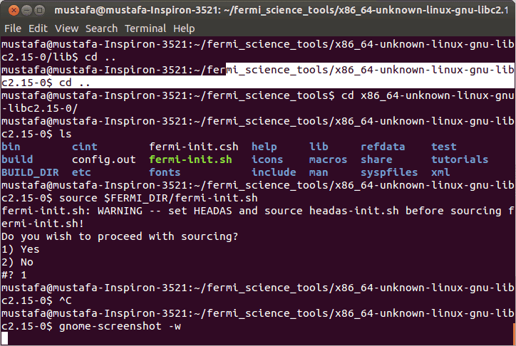

I ran the installation according to the directions on the website and I sourced it. I am not sure what to do next in order to run the software and access the Fermi data. I attached a picture of where I am. After I choose yes for sourcing, nothing followed. My problem is that I don't know what is next.

It seems this is a command line software. Anything needed to run the software, should be inside that bin subdirectory. Usually a file named the same as the name of the software. But if you couldn't find it, just give me a list of the files in that subdirectory.

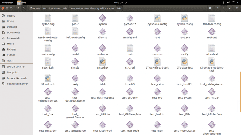

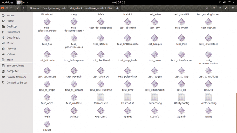

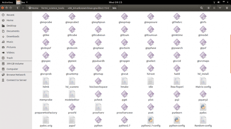

Thanks, this is a list of the files in the 'bin' sub-directory. I uploaded pictures of it.

None of them seem to be what you want!

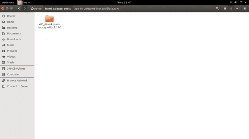

Anyway, from the path, it seems to me we're not in the right place. Is there a bin directory directly under "fermi_science_tools"?

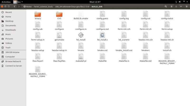

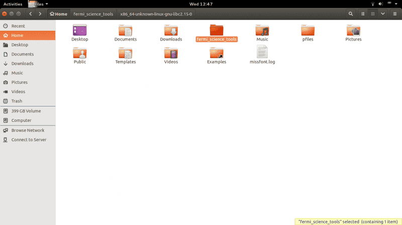

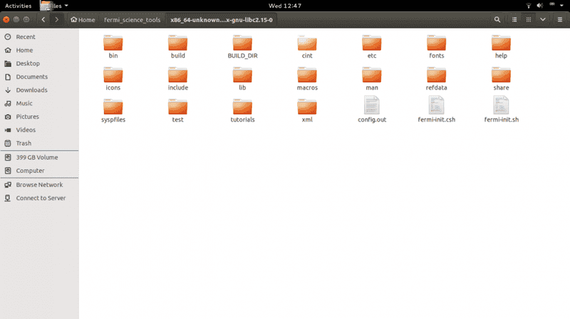

This is the directory to the BUILD_DIR folder. I took a screenshot of each folder and files till the BUILD_DIR.

OK, I now get it. If you look at this page, you can see that several tools are explained. This software package actually has no single file to work with. Each of the tools inside it has its own file and all of them are in that bin directory.
