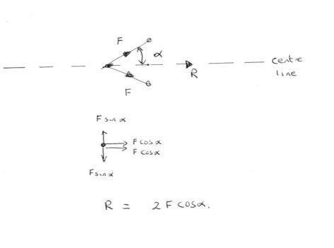

Well I'm going to use a Kentucky catapault as as example.
My first sketch shows a view looking down on the catapault with a stone loaded into the V and the elastic drawn back.
So the elastic is stretched and exerting force on the stone.
If we let go the stone will be slung forwards along the dashed line with a force I have marked as R.
Symmetry tells us that each of the forces in the elastic are equal and I have marked them as F.
We note that they are at an angle alpha to the eventual trajectory of the stone.
Now this is very important.
R is the resultant of the two forces F acting on the stone.
That is we could achieve the same effect if we slung the stone forwards with a single force R
This combining of two forces to make a resultant can always be done.
Resolution of forces is the exact opposite process.
That is we split a single force into two other forces or if you like replace it with two other forces.
Usually is makes sense to replace with two forces at right angles to each other.
I have done this in the second sketch.
Here I have replaced each of the forces F with two forces at right angles to each other. One direction is along the dashed line of R.
I have used the formula that the resolution of F along R is Fcosα and at right angles to R is Fsinα.
Since the effect is the same if I replace the forces F with the resolved forces Fcosα and Fsinα, I can pick two and recombine in a different order.
So If I calculate the resultant of two forces Fcosα I get R = 2Fcosα acting along the line of R
Interestingly if I take the two forces at right angles to R I get them opposing each other and cancelling out ie their resultant is zero.
This, of course is what we expect if the stone is to be slung along the dashed line - there is zero force pushing it sideways.
Does this help so far?

Yes a resultant is exactly the result of combining forces. √
As to formulae, look carefully at my sketch.
There are two forces F acting on the stone (one for each side of the elastic) so we double the effect of a single F acting (hence the 2 in the formula).
The effect of a single force F in a direction alpha to its line of action is Fcosα
By effect I mean the force acting in the direction alpha I would have to replace it with.
The effect of a force acting in a direction at right angles to alpha is Fsinα
Now there is more to it than this but this is enough to complete your question and to take forwards to the next stage.

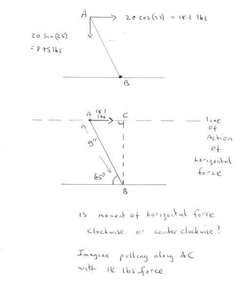

Did you draw the diagrams?
Civil engineers draw lots of diagrams.
It should look something like my top sketch with the horizontal and vertical forces acting at A.
Now I have shown the beginning of the calculation of the moment for the horizontal force in the bottom diagram.
Yes we have the forces.
But the lever is leaning over at 65°.
So we must do some geometry to find the perpendicular (orthogonal) distance between the line of action of the horizontal force and B.
This is again simple trigonometry, you should be able to do.
Knowing that AB = 9 inches, can you state what the perpendicular distance is and calculate it?
When you know the force and the perpendicular distance you can calculate the moment.
Is this moment clockwise or counterclockwise?
Can you do a similar diagram for the vertical force? (there is no need to post it)
