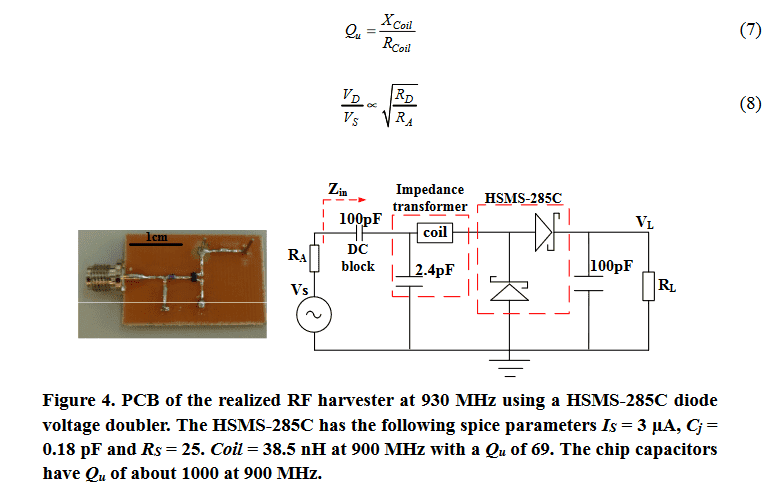

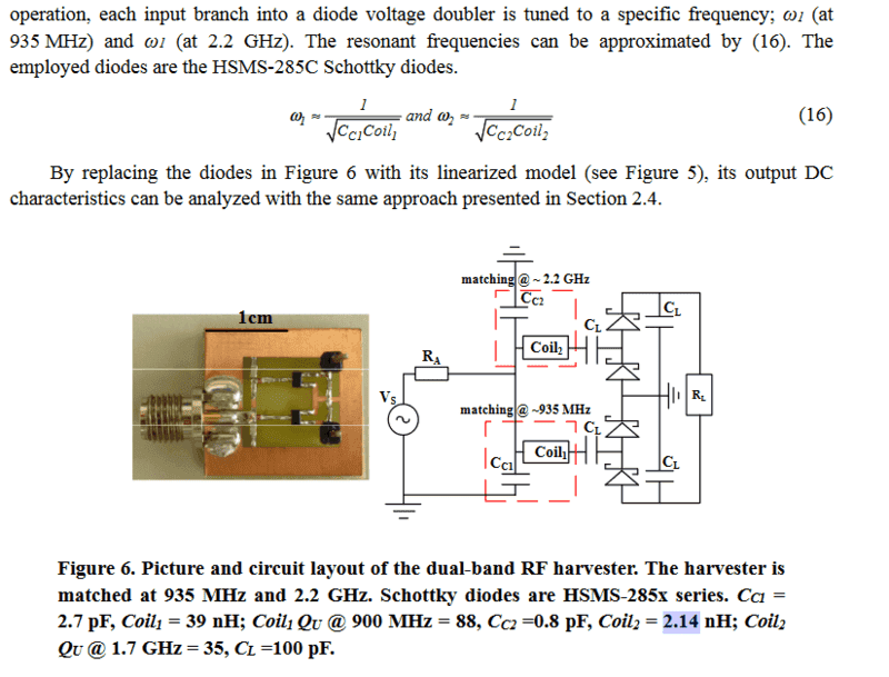

Having issues with getting the same series resistive and reactive impedance of the coil and cap they did in the figures
reactance equations, angular frequency, and Q
The only thing I could think of was using Q=sqrt(6000/50)-1 = 10.9, which then gets me XL=545 and XC=550, or 96.4nH, and 0.32pF at resonance of 900Mhz. I tried seeing if Zin=Zout equation would bring me close, so I tried Z=545+(50-550)=45, then XL for 38.5nH was 217.7, and XC for 2.4pF was 74. Of course Z=217+(50-74) equals 193. so 45 does not equal 193. but then I realized there was an absorption method for the stray capacitance inherent in the diodes. totaling roughly 0.36pF for 0.18pF each diode. So from here I tried calculating the two capacitance I had as if they were in parallel, giving me around 0.68pF total. With an XL of 220, and XC of 260 I tried Z=220+(50-260)=10. Closer, but not quite. The full research paper I am referencing doing my homework on: https://www.aimspress.com/article/id/274

I think the antenna is a quarter wave vertical, presumably 50 Ohms, although I cannot see the impedance of the antenna stated. But I notice that the matching network shown, which is an L-match, is configured to produce a step down in impedance to the diodes rather than the required step up.
I also tend to think that it might be better to add the signals at RF rather than at DC. Adding the signals at RF gives a higher RF peak voltage.
Interesting, I could give that a try, although I will have to dig through my textbooks, I forgot how to add the signals at RF cause I usually do it at DC. Though I've never had to analyze something this complex before.
Yeah I would presume it was at 50 ohms as well, as well as the paper suggests it to be used with (~λ/4 at 900 MHz, and 2200?) and because the diodes have such a low forward voltage and the junction capacitance is roughly 0.18pF each, I would assume the matching circuit might have to match down as to not add more components due to parasitic effects.
