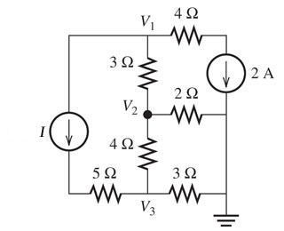

Having trouble with some review circuits using nodal analysis :(
I'm trying to find node voltages for v1, v2, and v3.
I = 3.1A
V=IR
My method of going about and solving this was fairly straight forward I thought. The way the question is set up, I believe nodal analysis is already ready to go. So I started with
KCL(v1): 2 + 3.1 + (v1-v2)/3Ω = 0
KCL(v2): (v2-v1)/3 + v2/2 + (v2-v3)/4 = 0
KCL(v3): (v3-v2)/4 + v3/3 - 3.1 = 0
Now it's been a while since I've done this (nodal analysis), but I now have 3 eqns and 3 unknown variables. The answer I have is -21.2V -5.87V and 2.8V respectively.
It's one of those, "I've tried all my guesses, need some reassurance before I commit to my last chance" scenarios.
Any helpful on this would be great! Thanks :D
Note that I haven't tried the brute force method of just solving for everything, or the mesh current method.
Have you substituted those back into the equations to verify they are the solution? The equations look right.
Have they taught you the superposition theorem? That way you could handle the problem one current source at a time ...
I solved the system and found v1 = -20.78V, v2 = -5.78V and v3 = 2.67V
I got
V1 = - 21.17
V2 = -5.87
V3= +2.80
so we're close.
Well, I got:
V1 = -127/6
V2 = -88/15
V3 = 14/5
which is the exact solution. :cool:
The 12 digit floating point approximation would be:
V1 = -21.1666666667
V2 = -5.86666666667
V3 = 2.80000000000
