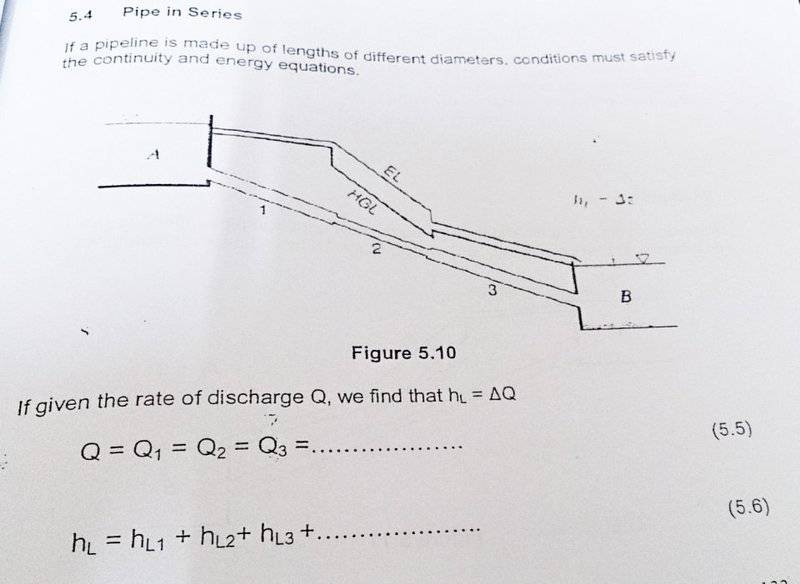

The head loss formula in series pipe is a mathematical equation used to calculate the change in pressure or energy loss in a series of pipes connected in a series. It takes into account factors such as pipe length, diameter, roughness, and flow rate to determine the amount of head loss.
The head loss formula in series pipe is derived from the fundamental principles of fluid mechanics, specifically the Bernoulli's equation which relates the pressure, velocity, and elevation of a fluid at any given point. By applying this equation to a series of pipes, the head loss formula is obtained to calculate the pressure drop across the system.
The head loss formula in series pipe assumes that the fluid is incompressible, the flow is steady and fully developed, and the pipe is smooth. It also assumes that there are no changes in elevation and the fluid properties remain constant throughout the system.
The head loss formula in series pipe is commonly used in engineering and construction projects involving pipe networks, such as water supply systems, irrigation systems, and HVAC systems. It helps engineers and designers to determine the appropriate pipe sizes and pump specifications to achieve desired flow rates and minimize energy losses.
While the head loss formula in series pipe is a widely accepted method for calculating pressure drop in pipe networks, it does have certain limitations. It may not accurately predict head losses in systems with complex geometries or non-Newtonian fluids. Additionally, it does not take into account factors such as pipe fittings, bends, and valves which can also contribute to head losses in a system.
