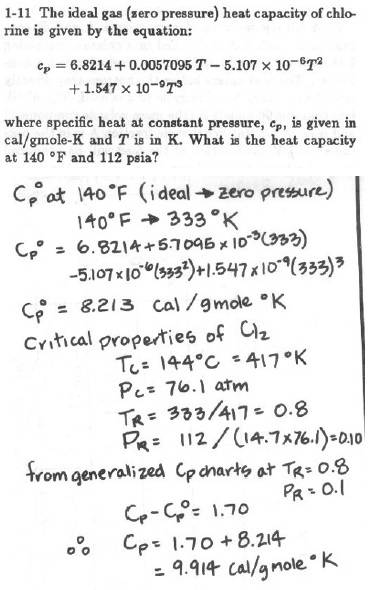

I Heat capacity for a real gas using the ideal gas (zero pressure) equation
The discussion revolves around calculating the heat capacity of a real gas using the ideal gas equation at zero pressure, specifically addressing confusion over the transition from reduced properties to the equation Cp - Cp° = 1.70 cal/molK. Participants express uncertainty about the derivation of this equation and the use of compressibility factors from generalized charts. The conversation highlights the need for accurate integration of partial derivatives and the challenges of applying generalized correlations without sufficient resolution in available charts. It is noted that the author may have overestimated the heat capacity departure by a factor of two, indicating a potential error in the methodology. Overall, the complexity of deriving heat capacity for real gases using ideal gas assumptions is emphasized.
gmaverick2k
42

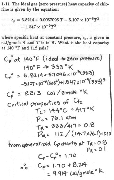

Summary:: Heat capacity for real gas with ideal gas (zero pressure) equation
I'm looking at this problem and I'm stuck.
I usually question everything but this problem is confusing me.
I don't know how they've made the jump from reduced properties (from generalized Cp charts(?)) to Cp-Cp°=1.70 cal/molK
Usually Cp-Cv=R
I've searched online and it seems Cp-Cv=ZR
This is not the same as Cp-Cp°=ZR, which would mean they've made Cp°=Cv (zero pressure so this is true?)
Has the author got the compressibility factor from the generalised compressibility chart for the Pr and Tr (Z=0.92)
I'm confused how they've made something straight forward
Below is the problem plus the authors solution:

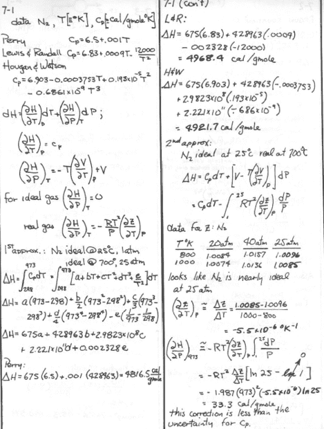

At constant temperature, the effect of pressure on molar enthalpy is $$\frac{\partial H}{\partial P}=V-T\frac{\partial V}{\partial T}$$This is used in conjunction with $$PV=zRT$$This leads to $$H(T,P)=H(T,0)-RT^2\int_0^P{\frac{1}{P}\frac{\partial z}{\partial T}dP}$$The heat capacity can be determined by taking the partial derivative of the enthalpy with respect to temperature at constant pressure. The resulting integrals are evaluated using the principle of corresponding states.
that's for calculating the departure enthalpy from ideal, i.e. enthalpy difference for real gas. the question is asking for heat capacity only
What did I say in my last sentence? Do you not know how to take the partial derivative of my enthalpy equation with respect to temperature?
I've used these in a previous example from the same book about real gas departure function. This problem in the OP stumped me.
$$C_p=C_p^0-2RT\int_0^P{\frac{1}{P}\frac{\partial z}{\partial T}dP}-RT^2\int_0^P{\frac{1}{P}\frac{\partial^2 z}{\partial T^2}dP}$$

This equation assumes that the partial derivative of z with respect to T at constant P is independent of P (which is incorrect).
i think for that example the pressure remained the same at 25atm and Z was interpolated. the gas (nitrogen) changed from 1atm and 298K to 25atm and 973K, i.e. simultaneous change in T & P. looking to see if departure from ideal was significant at end conditions, not so in this case.

hi the top part which isn't hand written

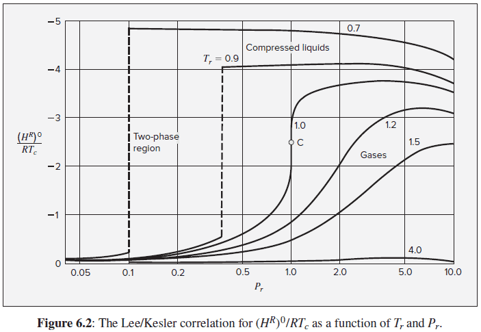

OK. There must be a chart in the book of ##\frac{C_p-C_p^0}{R}## as a function of reduced temperature and reduced pressure. This is what they must have used.
its from the american professional engineers exam set by Randall robinson. the accompanying reference manual doesn't include this chart. the only chart included in the thermo section is the nelson-obert generalized compressibility chart
Well, you are going to need that chart I mentioned to solve it, or you are going to have to numerically (manually) differentiate the enthalpy departure function at the desired reduced pressure with respect to reduced temperature.

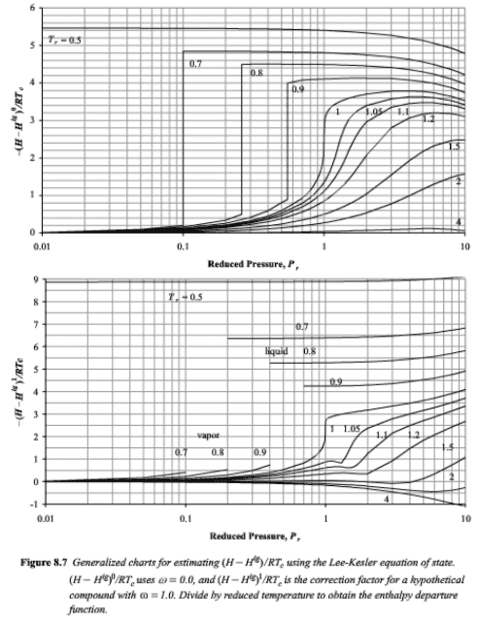

is there a way to translate this from the chart in post #16?

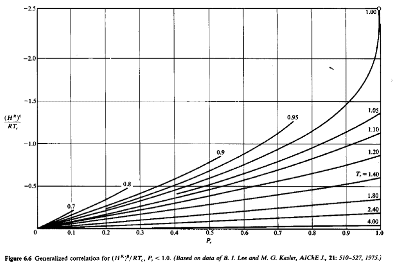

Something like that, but your charts don't have enough resolution to get what you want. See Fig. 6.6 of Introduction to Chemical Engineering Thermodynamics by Smith and Van Ness.

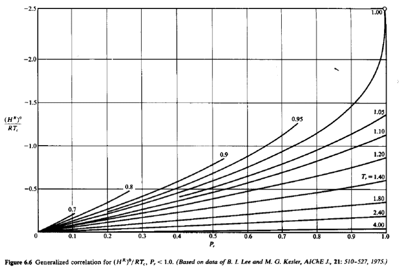

i assume its this from the 8th ed. So Tr = 0.8 and Pr = 0.1.. more confused the deeper i go
actually from older 4th ed.
say the left hand term is -0.18?
The partial derivative of the ordinate with respect to the reduced temperature (evaluated at reduced temperature of 0.8) at constant reduced pressure (abscissa = 0.1) is the residual heat capacity divided by R at the desired conditions. The partial derivative evaluated this way should come out to about +0.85 (dimensionless) if their answer is correct.

If ##y(p_r,T_r)## is the ordinate on the plot, then a 2nd order accurate numerical approximation to the residual heat capacity is $$\frac{C_p^R}{R}=\frac{y(0.1,0.9)-y(0.1,0.7)}{0.9-0.7}$$
From the graph, it looks like the authors overestimated the heat capacity departure (aka residual heat capacity) by a factor of about 2.

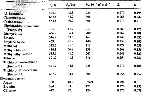

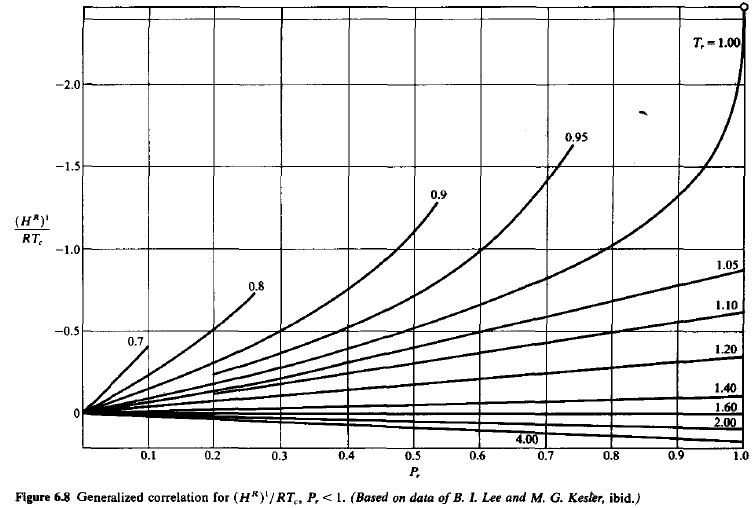

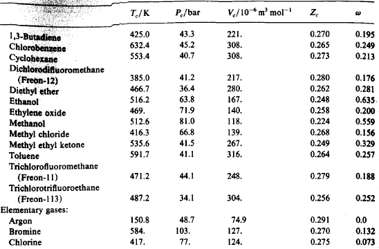

it looks like there's another graph with the superscript 1 for the ordinate. i think this takes the acentric factor into account. for chlorine ω=0.073
Likes Chestermiller
You're right. It looks like that would substantially reduce the disagreement.
i'm confused, the ordinate is
with enthalpy, H explicitly stated. how have you arrived at this
? where has the critical temp, Tc term disappeared to?

$$\frac{\partial \left(\frac{H^R}{RT_c}\right)}{\partial T_r}=\frac{\partial \left(\frac{H^R}{RT_c}\right)}{\partial (T/T_c)}=\frac{1}{R}\frac{\partial H^R}{\partial T}=\frac{C_p}{R}$$
Regarding Eqn. 4-168, you differentiate each term separately
Likes gmaverick2k
  • #33
ok, using plot digitizer for points on both graphs..
Yes, it looks like the author has overestimated the heat capacity by a factor of two assuming this is the correct methodology. I wish authors didn't skip on the working outs. i guess the fun is in the connecting of dots..
