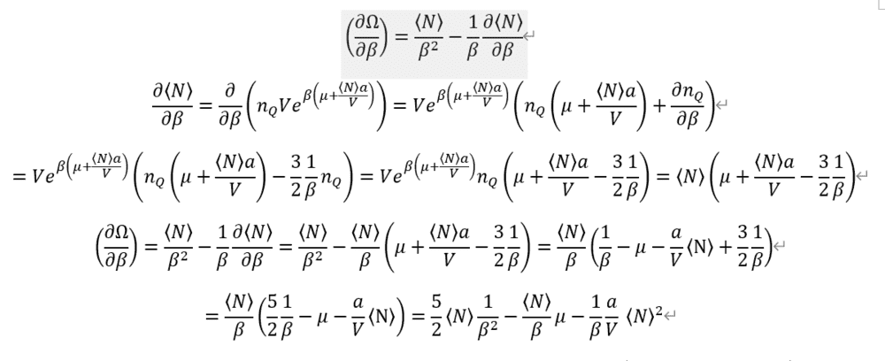

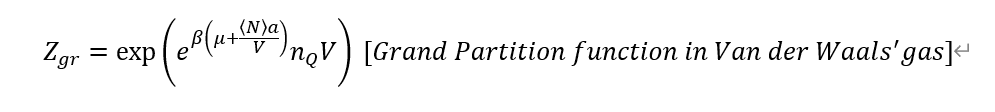

First, in the textbook grand potential for van der Waals' gas is
Next, I calculated routinely, but it's so complex.

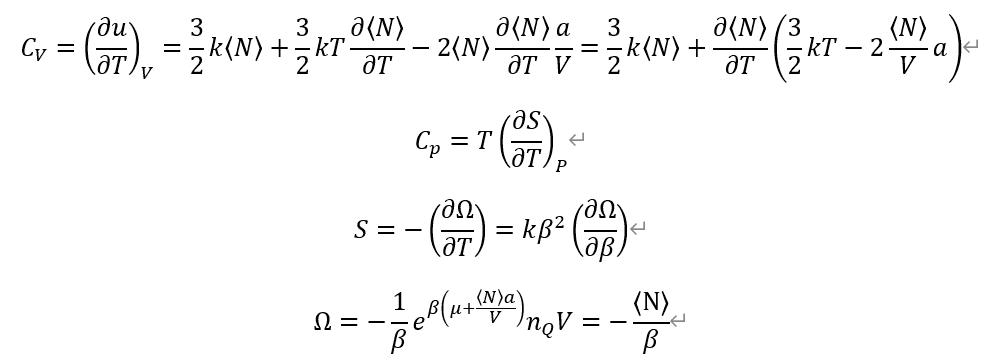

The internal energy come from previous problem. I guess it's right.
From definition of each Heat capacities. And, Entropy from Grand potential Omega.
I used previous calculation on average particle number <N>.
<N>=exp( \beta (\mu + <N>a/V))*n_Q*V
Also, n_Q is quantum concentration, which come from Ideal gas partition function, and define (m/(2*\pi*\hbar^2*\beta)^3/2
So, n_Q also depends on \beta or Temperature T.

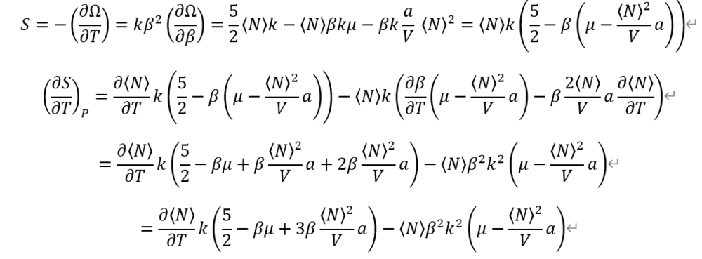

Entropy is so complex.
And I given up, because it's so complex for calculating by hand.
Where am I wrong?
Well, one thing you're doing wrong is assuming N is a function of T.

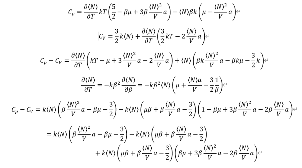

Are you familiar with the following equation for an arbitrary equation of state:
$$C_p-C_v=T\left(\frac{\partial V}{\partial T}\right)_P\left(\frac{\partial P}{\partial T}\right)_V$$

Thanks!
I have checked all of my equation... And, I found several mistakes.
By your feedback, I tried it without derivative of N respective of T.
And I got a right Cp value. 5/2 Nk.
And also I will try the equation you gave me.
Really Really Thank you. :D

That Cp value is only for an ideal gas, right?
Likes Astrocyte
Yes. I only tried it about Cp value, because the van Der Waals gas's one is so complicated.
In addition, that Cp value come from
$$ \ln{\frac{⁡⟨N⟩}{nQV}} = \ln{\frac{⁡⟨N⟩βP}{nQ⟨N⟩}} = ln⁡{\frac{βP}{n_Q}} $$
in Entropy term.
And fortunately, In my midterm, my professor didn't ask about heat capacity, and Van der Waals' gas.
