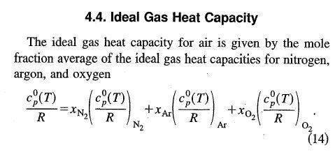

Hello,
would someone know where can one find tabulated values for the heat capacity of air [itex]c_{p}[/itex] or the ratio [itex]\gamma = c_{p}/c_{v}[/itex]?
I need those at low temperatures and pressures, e.g. tending towards zero.
So far I was only able to find [itex]\gamma[/itex] tabulated for high pressures in Perry's Chemistry Handbook.
Many thanks in advance.

This is what I also found:
http://www.nist.gov/data/PDFfiles/jpcrd581.pdf
But the low temperature/pressure data is only on the dew/bubble lines where air becomes liquid...
I need data for air in the gas phase
Here's a source where you can determine Cp and Cv for the individual components (ie: N2, O2, Ar, etc...) for any pressure and temperature, though it doesn't combine those gasses in the form of air. I'm not absolutely sure but I would assume the overall Cp and Cv would simply be some function of the partial pressures.
http://webbook.nist.gov/chemistry/fluid/
Maybe someone else can provide a function for how they get combined.

Perhaps this is the formula you were referring to

Although gamma is a dimensionless number, its two components are not dimensionless. They are usually expressed in units of energy per unit of mass. As such, they are largely independent of pressure.
Specific heat at constant volume is obviously independent of pressure. Specific heat at constant pressure has the same value for a pressure of 50 hPa as for a pressure of 1000 hPa.
I think that you may safely use the tabular values in the Engineering Toolbox for your low pressure and low temperature calculations. Within the accepted limits of scientific accuracy and precision, of course.
I was able to find the book "Thermodynamic properties of air" and it will do
