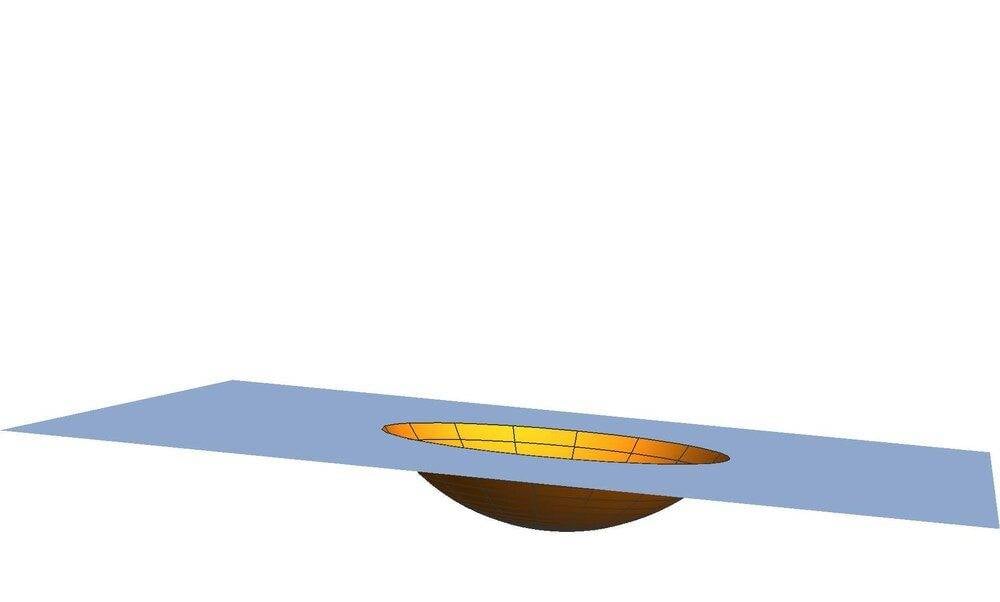

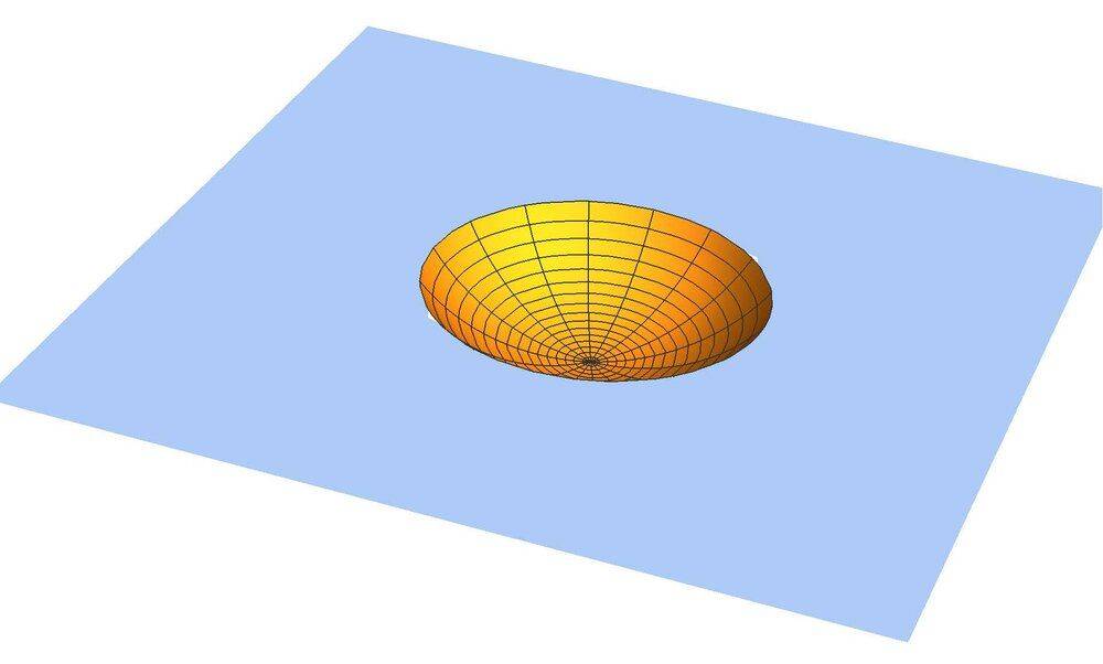

I try to upload an image of the surface of the semi-infinite solid. The spherical cap is isotherm while the rest of the surface is adiabatic. The semi-infinite solid is beneath the surface. I apologize for the misunderstandings.

Is the cap meant to be a perfect hemisphere (it looks like less how much less?). To which post does this refer ?
I refer to the first post. The cap is not meant to be a hemisphere. In normalization, length dimensions were re-scaled by means of ##R## (the radius of the sphere from which the spherical cap is derived), this means that ##p##, the depth of the cap below the surface, can vary from 0 to 1 (0 = no cap, 1 = hemisphere). I would like to calculate the stationary temperature field in this semi-infinite solid, with this strange spherical cap at constant temperature ##T=T_1## on its surface (in dimensionless form ##T=1##). Far from the surface the temperature is ##T=T_0## (in dimensionless form ##T=0##). In a spherical coordinate system (physical convention, polar axis perpendicular to the surface) centered at the "center" of the cap, the dimensionless equations should be:
