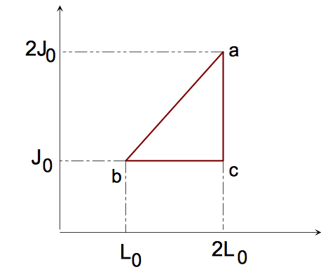

Find the efficiency of a three-step cycle heat engine that uses a rubber band (the cycle is shown in the figure), which idealized equation of state is J= aLT (J is the tension, L is the length of the rubber band per unit mass, a is a constant and T is the temperature). The specific heat capacity is a constant, c. Find the efficiency of this rubber band engine.
dQ=TdS=(dS/dT)dT+(dS/dL)dL
Nota that the path a to b is isothermal since J is proportional to L, then we can find the value of T_a and T_b using the equation of state and the figure. We have,

So, I would thank you if you could tell me if that efficiency is correct, I saw some pages solving the same problem that find the efficiency to be 1/3, so I am not sure about my calculation. Thanks in advance.
Not sure of the "work" this rubber band is doing or why anyone would call it a "heat engine". Never saw an efficiency calculation that took mass into account. Thermodynamic efficiency is proportional to delta T/T and your "efficiency" has no temperature dependence. Your math goes off of my screen.
Likes Pedro Roman
Let just say that we have a cycle as the one showed in the figure, which follows the following equation of state, J=aLT, and for that let us calculate the total work and the heat absorbed, in that sense one is able to compute the 'efficiency' of the 'heat engine'. This is just a textbook problem. The mass appears due to the fact that the heat capacity at constant length (c) and the length (L) have the following units [J/kg K] and [m/kg], respectively. As you said, the 'efficiency' must depend on the temperature, now I have written the efficiency in term of it. Also, I have split all equations to avoid they go off the screen. Thanks for your answer.
