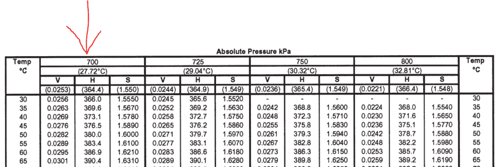

So I found this table. 7 bar equals 700 kPa, so this is the part of the table that would matter for that pressure. Would I have to replace the H in the equation you showed me to calculate the mass flow rate?
Sure. But before addressing that, please answer this question: Is the F12 under these conditions (a) a saturated vapor or (b) a superheated vapor?

I think its a superheated vapor.
Correct. So what are you taking as the exit state of the F12 from the exchanger.
