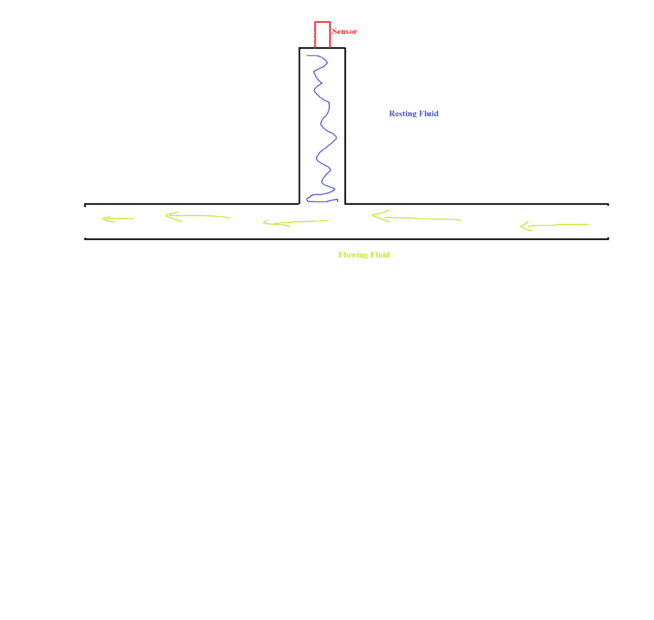

Hello,
I have the following problem and hope you can help me. I have the setup as shown in the drawing. A pipe that is flowed through, and in the middle of it another pipe, but at the end of this branch is a sensor. Initially the fluid would flow, with a temperature of 25°C. If my thought is correct, the pipe with the sensor (if there is a drain valve) would fill with the liquid and then rest, because there would be no more flow, since it has nowhere to flow.
Now the liquid is slowly heated (heating to about 350°C) and continues to flow the same way. How would the temperature in the branch change? This would have to be still relatively cold at the sensor, since no exchange of the liquid takes place, since no flow is present in the branch, or do I have there a mistake in my thought?
How would you calculate the heat exchange between the flowing and standing medium? Because there is heat exchange only there, which would then have to be "up" through the entire water column. Can we calculate this in a simplified way as forced convection on a plane wall and assume the fluid portion in the branch as a plane wall?
I hope the problem is apparent, because I would need to calculate the length of the branch so that a certain temperature at the sensor is not exceeded.
Thanks a lot!

Unless the branch pipe is externally cooled, you can't prevent it from eventually equalizing with the flowing main pipe.
What is the fluid?
The Fluid is Oil. The pipe isn't externally cooled, but is very thin and long, so the heat would be exchanged with the surronding air wouldn't it? So theroetically it wouldn't equalize, or am i wrong?
To simplify it I wantet to calculate the Temperature by the Sensor with the thermal restistance of the resting oil in the capillary and ignore the convection. Or is my thought to simplified?

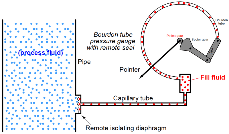

In that case, I would use a long coil of capillary tube, while independently supporting the sensor weight.
That would reduce convection through oil and conduction through metal., while increasing the surface for radiation into the surrounding air.
If the direct contact of the hot oil could damage the sensor, an isolating diaphragm could help.
Please, see:
https://instrumentationtools.com/pressure-gauges-remote-and-chemical-seals/
Likes erobz, Teru123 and russ_watters

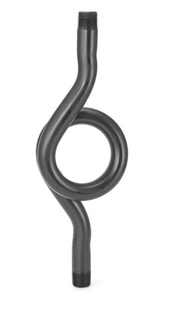

This is a common problem in plants with high pressure steam lines. They mount the pressure sensors/gauges on a pigtail. This is a pigtail:
And a link to the pigtail page from a manufacturer of pressure gauges: https://www.ashcroft.com/products/pressure/accessories/1098-1100-siphons/. This is not the only manufacturer that makes pigtails, it is one of the first web sites that came up when I searched using search terms pressure gauge pigtail.
Your thought is correct. The straight portion of the pigtail should be long enough to extend through the pipe insulation. The curved portion should be outside the pipe insulation. Since you are starting with room temperature oil in a pressurized line, then slowly heating the flowing oil, the pigtail will fill the cool oil. Heat transfer to air will be large enough, and conductive heat transfer through the oil will be low enough, that the pressure gauge/sensor will not get very hot.
Likes Teru123, russ_watters and Lnewqban

You can still do an analysis of this as a "cooling fin"
Since the tube is thin, metal we ignore thermal gradients across the pipe wall. The surface temp of the pipe at position ## x ## should be the same as the temp of the fluid at position ##x##. Using the following tip condition:
## h \theta(L) = - k \left. \frac{d \theta }{dx} \right|_{x= L} ##
Then;
$$ \frac{T(x) - T_{s}}{ T(0) - T_{s} } = \frac{ \cosh m( L-x) + (h/mk) \sinh m( L-x)}{ \cosh mL + (h/mk) \sinh mL} $$
Where;
## m^2 = \frac{h P}{k A_c} ##
## A_c ## is the cross - sectional area of the pipe ( liquid + metal )
Likes Teru123
After I wrote my previous post I was thinking the same thing: solve as a fin (conduction "inside" with external convection). I believe that is what you're showing in Post #20.
