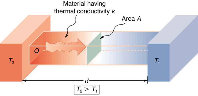

I recently read in a Khan Academy article that the rate of energy exchange through heat across a material of thickness ##d##, surface area ##A##, and thermal conductivity ##k## can be approximated by $$\dot{Q} = \frac{kA\Delta T}{d}$$ where ##\dot{Q}## is the heat rate and ##\Delta T## the temperature difference between the two sides of the material.
However, I am a bit confused by why the thermal conductivity of the media on either side of the material in question does not affect that heat rate across the "middle media," ##\dot{Q}##. Referring to the included image, what if the thermal conductivity of the media composing the body of ##T_1## was close to zero? Would the heat rate across the middle media not be affected? According to the equation for ##\dot{Q}## above, it is not.
Is ##\dot{Q}## solely a function of temperature difference, independent of the "sandwiching" media involved?

UPDATE: I think I understand what's going on. I believe that the heat rate across any media is, in fact, independent of the surrounding media's thermal conductivity with temperature difference between the surrounding media being the only external parameter of any importance. Please correct me if I am wrong.
Yes, this is correct.
If the surrounding media is a good insulator and the media in the middle is a good conductor, a heat flow equilibrium of sorts will eventually be obtained with a high temperature difference across the insulating material and a low temperature difference across the conducting material. The result will be (once this equilibrium is obtained) an identical heat transfer rate throughout.
Likes Jacob Wilson

If you suddenly change one of the end temperatures while holding the other end constant at the same temperature that both ends started with, the temperature within the conductor will depend on time, and ##\dot{Q}## will be a function of both time and position. However, at long times, when the conduction reaches steady state, the temperature profile in the conductor will become linear and the rate of heat flow will become constant.

Chestermiller said:
At long times, when the conduction reaches steady state, the temperature profile in the conductor will become linear and the rate of heat flow will become constant.
Is the steady-state condition for the conductor a fixed ##\Delta T##? In other words, must the surrounding media at temperatures ##T_1## and ##T_2## be approximate heat sinks?
Yes.
In the scenario depicted in your figure, yes. But, more generally, whatever the temperatures are at the two very ends of a conductor, at steady state, the rate of heat flow is given by your equation and the temperature varies linearly through the conductor from T1 at one end to T2 at the other end.
