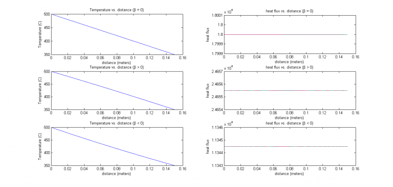

I'm now trying to sketch the temperature and heat flux profiles for ##\beta = 0##, ##\beta < 0##, and ##\beta > 0##. I think for ##\beta = 0##, the temperature profile will be a straight negative slope, and heat flux is just a straight horizontal line.
However, I am not sure about the other two
If the thermal conductivity of the wall is changing, how can the heat flux be constant conceptually? I think the conductivity will tend to go down as temperature goes up. At the beginning the temperature T1 > T2, the thermal conductivity will be at its lowest value, but will start decreasing as it goes along. If the material isn't uniformly conducting heat, how can the heat flow rate be a constant?
With a constant heat flux (or heat current), the temperature change per unit distance through the wall will vary with the local conductivity. So long as all the temperature changes add up to the total temperature difference between one side and the other of the wall nature is satisfied.
It’s very much like a series electrical circuit where there’s a potential difference across a string of resistors. The current only depends upon the total resistance and total potential difference. While the resistors may have different values along the way, the current is the same through each resistor. Each resistor will have its own potential change depending upon the current and the resistor’s value.

So then the heat flux profile for all 3 situations will just be a straight horizontal line. Only the temperature profile will change with ##\beta##
The temperature gradient decreases in such a way, that, when multiplied by the thermal conductivity, their product (the heat flux) is constant. The heat has nowhere else to go, so the local heat flux through the wall must be constant (as a function of position x).

The heat flux will be constant, irrespective of beta.

So I think I've convinced myself a number of times that the temperature profile for ##\beta = 0## is going to be a straight negative slope. Now...How the heck will I make a temperature profile when beta has a nonzero value? This is a nonlinear equation so I can't just do a plot of T vs. x on MATLAB, or at least not sure how to since the synthax will only allow me to define a variable, and I can't define it in terms of itself. How would you think of it if you just did it by hand? I should know how to do it by hand, but I like using computer software to analyze these things too
I would solve for x as a function of T, and then plot x as the abscissa and T as the ordinate.
Chet
Alright, well I just ran this through matlab, and it seems like unless ##\beta## is on the order of 100 or 1000, then it hardly makes a difference. The temperature profile is basically a straight line for all of them. Even when ##\beta## is around 1000 or 10,000, it is still straight with just some slight curvature.
Here is an example of my code for when ##\beta = 0##, the other code cells are identical except I change the value of ##\beta##

The temperature profile approaches a limiting curve as ##\beta## becomes infinite. You should be able to derive the equation for that limiting profile from your final equation. What is it, and how does it compare with what you got for ##\beta = 10000##? Does this explain why the profile doesn't change much over the full range of beta values?

Have you compared the temperature profile you get from this equation with what you calculate when beta is large but finite?
Chet
  • #31
Yes and the equation agrees with the plot for a large finite beta
