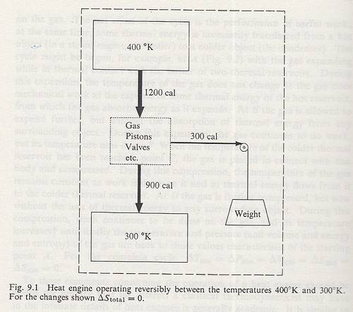

Hi guys can anyone please tell me that it is possible with an air conditioner of type inverter to put less energy than what the piece is receiving as heat. So let's say that on the inverter it says output KWh/ input KWh =4.
Henthalpy= G+TS
4*Hinput= Houtput inside the house
So to heat my house I use 4 times less energy if I just used a normal electric heater or this is what they write in product description?
If you use a standard electric heater, 100% of the electric energy consumed is converted in heat.
But, in if a 'heat pump', you use the electric energy to drive a compressor, and the machine converts low-temperature heat, available in the external surroundings, in the external air, mainly, to high temperature heat, that may be used to heat your room. The 'transportation cost' is lower than the energy costs of a resistance heater of the same heating power. How much lower depends on the difference of inside/outside temperatures. The larger the difference, the smaller the advantage with respect to a resistance heater.
A refrigerator (or heat pump, that is the same) is esentially a thermal engine working in reverse. Instead of taking heat from a high-temperature place, producing useful mechanical work, and discharging that low-temp heat in a low-temperature place, the refrigerator/heat pump takes low-temp heat from a low temperature place, injects mechanical power, and places the resulting high-temp heat in a high temperature environment...I believe that using '4 times less energy' may be too optimistic...

This two very clear pictures are from 'The Second Law', by Henry Bent:
How does delta S stay zero in both directions? So the reversed Carnot is the refrigeration cycle, but do these heat pumps use only one cycle, and is it possible that they have some newer technologies so that the efficiency of an air-air heat pump reaches 4 or 5 up to -20 degrees C?
400K reservoir ---> ΔE (cal) = -1200 cal ΔS (cal/K) = -3 cal/K
300K reservoir ---> ΔE (cal) = +900 cal ΔS (cal/K) = +3 cal/K
Weight -------------> ΔE (cal) = +300 cal
Balance -----------> ΔE = 0 cal ΔS = 0 cal/k
