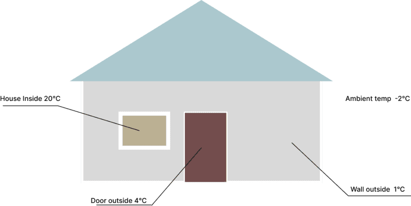

Hello,
My house has some heat loss. As an example I know the outside door temperature. How can I calculate the heat loss delta if I reduce the door temperature by 1 degree?
I know that there is a formula to calculate a heat loss based on the U-value of a fabric. But I can't get those values as the walls and even doors are not made from a solid material. So in most cases it is not possible for me to get U-values.
So I thought if it is possible to calculate it based on temperature of surfaces?
Details:
* Ambient temp: -2°C
* Door outside temp 4°C
* Door inside temp 20°C
* Door height: 2.2m
* Door width: 0.8m
How many watts could be saved by decreasing heat loss if I insulate the door and its outside temperature drops to 3°C ?
I need this to reason the house insulation in many places to my landlord. As now he is not sure if it makes sense but I pay a lot on my electricity bills.
I would appreciate any help with this.

The numbers given imply substantially worse insulation in the door than the walls. Heat loss is proportional to temperature difference, at the wall surface outside you have a 6C delta-T vs the wall at 3C delta-T. So, twice the convective heat loss (per unit area).
Thank you. I wonder if I can convert it into absolute values and finally into watts.
To generalize the task I can say:
what is the conductivity coefficient of a complex material if we know temperature difference on two sides, the surface area and the ambient temperature.

I can say from just observing temperature on those surfaces. The walls are significantly better and have 1°C while the door has 4°C. Windows temperature is 5°C
It looks like my task is not possible. I found out that it requires the heat flux (Φ) besides the temperature gradient (ΔT).
The heat flux is defined as the amount of watts transferred per square meter.
Knowing the heat flux I can get the R-value of the material using this formula R = ΔT / Φ
And I have no idea how can I measure the heat flux of a wall or garage door :)

I managed to calculate the R-value and the heat loss of the door. I was using the up to date temperature values.
Measurements
Door inside 19 °C
Room temp: 20.8 °C
Outside temp: 1 °C
Calculations:
Room and the inside door surface temp difference is 20.8 - 19 = 1.8 °C ,
Ambient and the inside door surface temp difference is 19 - 1 = 18 °C
Checked the spreadsheet.
Found my inside temp difference in the first column. Then found the column with the outside difference and the R value:
R-value (imperial) = 7.3 ft2·°F·h/BTU
Calculated the metric RSI value
RSI (metric) is 7.3 / 5.678 = 1.29 m2·K/W
The heat loss would be
Q = ∆T / RSI = (19 - 1) / 1.29 ≈ 14 W/m2
My only question is what temperature difference should I use when calculating heat loss? ambient - room or inside surface - ambient or surface inside - surface outside ?
For the door itself I would use (surface inside - surface outside) but the different methods should change the (imperial) R by less than one. Your overall errors will be that large anyway, so don't worry.
