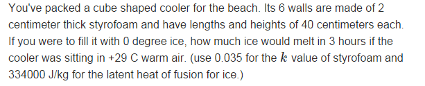

Q = kAΔT/L
[/B]
so I need to find the volume of the cooler, and then the volume is the volume is ice in it?
then I need to find the surface area of 1 side of the cooler, than multiply it by 6. then plugging in the total area in Q = kAΔT/L
is this a good approach to the problem?

Hey, that L is not latent heat in equation but length.
oh, sorry! good catch

There is another equation for heat transfer what is that?
Q = L m
we equate them so we get
L m = kAΔT/Length
we have L
we have k
we have A and L
I'm assuming ΔT is 29 C?

How to bring time term here which is 3 hrs?
i think the answer we get, if we did all the algebra, is the amount of heat per seconds.
so we just convert 3 hours to seconds. then multiply by the heat per seconds
correct?
First of all the formula for heat conduction is
Q = kAtΔT/L where k is constant , A is area, t is time, ΔT is temperature difference and L is length.
Likes goonking
In case it's not obvious... In this case L is the thickness of the insulation (eg the length of the heat path)
Likes goonking

Q = (0.035) (0.02m x 0.4m) (10800 seconds) (29 C) / (0.4m) = 219.24 joules
i believe we set Q = L m = 219.24 joules
m should be 6.56x10-4kg
correct?
correct?
Yes, it is correct.

No "A" is the surface area. You were right when you wrote..
L is the length of the heat path which is through the walls (eg 2cm).
Yeah, sorry.
The length to be taken is 2cm.

oh, i forgot to multiply the area by 6, so it should be 6( 0.02m x 0.4m) = A
so new answer should be 26300 joules
i would have never thought the length was 2cm

kAΔT/L gives you the power (energy per second) flowing through the walls. If the walls are thicker (better insulated) then L is longer and less power flows. Make sense?

ok, got the answer to be 1.57 kg, sounds much more reasonable now
Yes. I make the equation..
Q(Joules) = (0.035) (6 * 0.4m x 0.4m) (10800 seconds) (29 C) / (0.2m)

should be 0.02 m
Yes you are right.
Yes sorry /0.02.

It is 0.157 kg.
make sure you put in 0.02 m, not 0.2m

Just a thought but..
The question isn't clear if 0.4m is the inside or outside dimension of the box.

true, i was thinking that too when I tried to draw out the cooler
Isn't the answer given in your problem so you could verify?
yes, the answer was 1.57 kg
Ok. Just for info.. If you assume they meant the outside dimension then the insides are about 0.36 * 0.36. If you use that for the area the result is about 1.28kg. Real world the answer will be somewhere in between the two.
