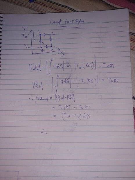

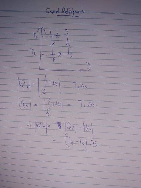

Heyy. I have encountered the same problem as you guys. My only catch with this explanation is that from the T-s diagram we can show the magnitude of both Qh, QL and W to be same. Would be helpful if you guys can help me figure out on what gives?
In the reverse cycle of a real engine it takes more work than was produced in the forward cycle to reverse the heat flow to the hot register. So if you ran the engine one complete forward cycle and saved the output (e.g. by lifting a weight) that stored energy would not be enough to return the hot register to its original state.
It is always the case that ##W=|Q_h|-|Q_C|##. So in the reverse cycle ##|Q_c|## will be less than ##|Q_c|## in the forward cycle if ##|Q_h|## is the same.
