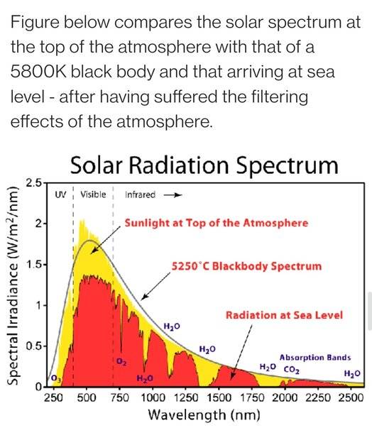

I came across an excellent explanation that appears to be closely related to my question at https://www.quora.com/If-UV-rays-ar...4&share=276a3ba9&srid=2W7O&target_type=answer
Certainly the distribution of energy across the wavelengths is important to the question. The diagram at that link makes it look as though most of it is infrared or below. According to https://sos.noaa.gov/catalog/datasets/climatebits-solar-radiation/, it's about equal.
But both consider what arrives at the top of the atmosphere. By the time it gets to us, a significant slice of the IR (and UV) has been absorbed in the atmosphere. Also, a chunk of the radiation below visible is radio waves, which simply pass through us.
So as regards answering the question in post #1, the only other piece to the puzzle you need is why the UV can make our skin feel hot later.
But to understand why the visible light does not immediately feel so warm on the skin, it is necessary to go into how those wavelengths interact with our bodies and how we sense warmth.
Surprisingly, perhaps, we do not directly sense warmth: we detect temperature gradient.
That's why I can feel hot at night in an air temperature I would find comfortable in daytime. In sleep, core temperature drops. It also explains the paradox that people who get hypothermia can feel so hot they start taking clothes off.
So maybe the IR is absorbed so readily (by water molecules in particular) that it sets up a sharp temperature gradient across the sensing cells, while the energy from visible light gets absorbed across a deeper layer.
I get it now.
I came across an interesting plot which confirms what you mentioned about filtering of sun's radiation by the atmosphere. Below is a screenshot that shows in orange color the actual wavelengths from sun reaching us and it's taken from https://www.quora.com/What-are-the-...9&share=a89917a3&srid=2W7O&target_type=answer
As can be seen, the area under the curve is much less for the infrared wavelengths as compared to the area under other wavelengths of the sun's radiation spectrum. The area tells us if the heat radiation is high or low. Clearly the infrared region area is not that much.

haruspex said:
Yes, but it does not discriminate IR from radio waves, does not quote actual percentages like the NASA link does, and does not consider what is lost in coming through the atmosphere.
Regarding what fails to reach us as sun's radiation, can we say the following?
  • Visible part: The atmosphere above the earth allows most visible light to pass through to earth's surface with some of it being reflected back into space from molecules in the atmosphere.
  • UV part: The ozone gas molecules in the atmosphere absorbs UV and some UV rays that fail to get absorbed reach the earth's surface.
  • Infrared part: The greenhouse gas molecules in the atmosphere of carbon dioxide, methane and nitrous oxide absorb infrared radiation and only some of it manages to reach the earth's surface.
So, the peak of heat radiation from the sun comes in the form of visible light as it's not absorbed by any molecules in the earth's atmosphere.
Depends on what you mean by "peak"...
What is interesting to know is perhaps "most energy" i.e the area in the diagram in post #23
The difficulty applying that image to the question in this thread is that most of the visible light energy that doesn’t make it to earth’s surface (the yellow area in the visible band) is that which is reflected by clouds. The context of the question would be without clouds.
Of course, that also applies partly to the IR.
