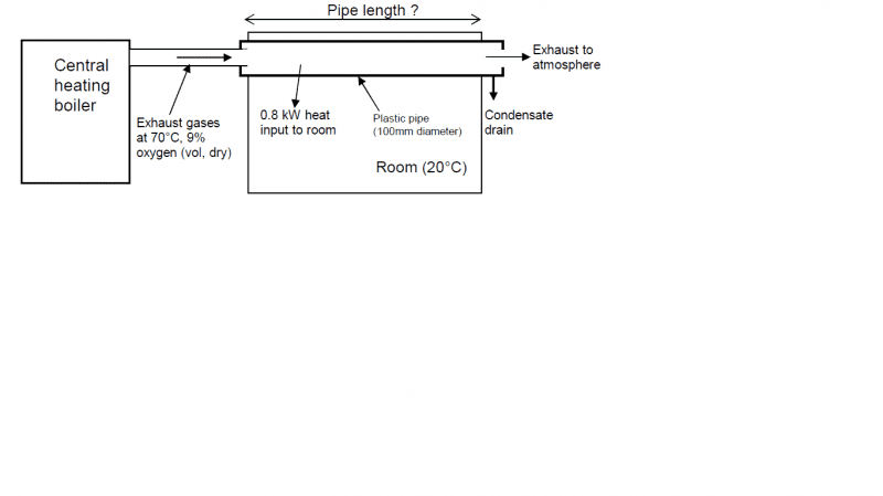

The exhaust gases from a natural gas-fired central heating boiler leave the boiler at a temperature of 70 deg C. The oxygen content of the exhaust gases is 9% by volume (dry). The rate of energy input (Gross calorific value) to the boiler from natural gas is 16kW. The gross calorific value of natural gas is 55MJ/kg. For the purposes of all calculations assume that natural gas is 100% Methane (CH4). The pressure in the combustion chamber of the boiler and throughout the heat recovery system is 1 bar.
The exhaust gases are blown down a plastic pipe situated in a room are then exhausted to atmosphere, as shown in the diagram attached. The warm pipe provides a heat input to the room of 0.75kW. The pipe is 100mm in diameter and is made up of a number sections 1m in length.
The overall heat transfer coefficient (U) for heat transfer from the exhaust gases through the pipe to the room is 9.5 W/m^2K. The room temperature is 20 deg C.
Calculate:
1. The temperature to which the exhaust gases must be cooled in order to recover 0.75kW of heat.
2. The number of 1m length of pipe needed to provide the heat input of 0.75kW to the room.

I am completely clueless on how to continue afterwards. The hint told me to make an assumptions of the final temperature that will allow a heat recovery of 0.75 kW.
How many kg/s of CH4 do you feed the boiler ? How many kg/s of exhaust gas does that yield ?
Then: if the room temperature is 20 degrees, what is the minimum exhaust temperature to the outside world ?
The exercise instruction to consider the water in the exhaust from the boiler to be in the vapour phase at 70 degrees and 1 Bar is clear, but not very realistic, I would say.

As BvU indicated, you need to start out by determining the mass flow rate through the exhaust pipe. You are given the heat transfer rate from the exhaust pipe to the room(0.75 kW). From this, you can calculate the exit temperature from the exhaust pipe. Don't forget to take into account the heat of condensation for the part of the water vapor that condenses (probably most of it by the exit). Once you know the exit temperature, you need to calculate the part of the heat load occurring over 5C increments within the pipe. From this, you can use the overall heat transfer coefficient and the room air temperature to determine the length of each section required to bring about each 5 C increment. You then add these up to get the overall length.

[tex]\frac{dH}{dx}=-\pi DU(T-20)[/tex]
where T is the local temperature at axial location x along the exhaust pipe and H is a function of T (the enthalpy flow along the tube). If the water were not condensing, H(T) would be given by: ##H=MC(T-25)## where M is the molar flow rate and C is the heat capacity per mole. You integrate the equation until the temperature is 43 degrees.
You approximate the above equation in finite difference form by:
##H(T(x+\Delta x))-H(T(x))=-\pi DU(\frac{(T(x+\Delta x)+T(x)}{2}-20)\Delta x##
where ##\Delta x ## is the incremental distance along the exhaust pipe. Solving for ##\Delta x##, we get:
##\Delta x = -\frac{H(T(x+\Delta x))-H(T(x))}{\pi DU(\frac{(T(x+\Delta x)+T(x)}{2}-20)}##
So you specify 5C increments on T, evaluate the right hand side, and this gives you the ##\Delta x## increment for that temperature change. Your spreadsheet is already practically set up to do this.
Chet
nightingale said:
55* 10^3 *16*m = m * [1*44* 0.871 (CO2) +1.3417*32*0.923 (O2) +12.565*28*1.04 (N2)] * (70 - 25) + 2 * 18* (2626.3-104.8) + 16*16
I realized that this is the same as using mass of each products/kg of fuel [Fuel of CH4 =16kg]
55* 10^3*m = m * [2.75* 0.871 (CO2) +2.6834 *0.923 (O2) +22 *1.04 (N2)] * (70 - 25) + 2.25 (2626.3-104.8) + 16
and thus m = 3.33 * 10(-4)... at this point I don't really know what the unit is.
Did I make a mistake? Thank you.
No. I confirm this as the mass flow rate kg/s of CH4 fed to the boiler. I got the kg-mole flow rate of CH4 fed to the boiler as 2.1x10^-5 kg-mole/s, in agreement with your result. Incidentally, the first equation should not have a second 16 multiplying the first 16.
Chet
You can get upper and lower bounds to the length of the tube by recognizing that the temperature difference is always going to be less than 70 - 20 = 50 C, and greater than 43 - 20 = 23 C. You can use such results to compare with the detailed result you get when you integrate the heat balance equation.
##0.1\pi (9.5)(50) L_{min}=750##
##0.1\pi (9.5)(23)L_{max}=750##
Lmin = 5.0 m
Lmax = 10.9 m

I feel as if I'm making a mistake here... I couldn't quite get the temperature. What do I do with the rest of temperatures? Help please?
Chestermiller said:
The differential heat balance equation should be:

  • #31
nightingale said:
Thank you for pointing that out.
Q = U * Area * Delta T
750W = 9.5 W/m2K * (3.14*Diameter*Length)*(T2 - T1)
750 W = 9.5 * (3.14*0.1*L)* (70-20)
5m = L
Yes. See post #28, which I have corrected because I originally used the wrong heat load. It shows that the length of the pipe will have to be between 5 m and 10.9 m. See my next post to see how to calculated it precisely. The temperature is going to be changing along the pipe, and this has to be taken into account.
Chet
  • #32
nightingale said:
Chet,
Since the water starts to condense at 49 deg C, does this mean there' s no water condensing in the system? To which then I use
H=MC(T−25)
You can for the portion of the pipe where T > 49, but, in the region where 43<T<49, you can't because water is condensing. The water condensation contribution is very important.
I should have been more explicit in what H actually is. Using your notation, H(T) is given by:
H(T) = m * ([2.75* 0.871 (CO2) +2.6834 *0.923 (O2) +22 *1.04 (N2)] * (T - 25) + 2.25 (f hv(T)+(1-f) hl(T)-104.8))
where f is the fraction of water that is vapor, hv(T) is the enthalpy of saturated water vapor, and hl(T) is the enthalpy of saturated liquid water.
If so, what do I take for x to find H? If I was supposed to find x and not H, using the formula quoted and given above, what do I take for H? I don't really understand what H stands for. Is it the 750Watt?
I presume that the: H(T(x+\Delta x))-H(T(x)
where the temperature is the temperature between the increments, perhaps like this?
H (70) - H(20)
H (65) - H(20)
and so on until H (43) - H(20)?
No. In the first increment of pipe length, if you are using 5 degree increments, then you have H(70)-H(65). You are going to be adding up all the small incremental lengths ##\Delta x## to get the total length of the pipe. The following equation gives you the formula for calculating the incremental lengths:
[tex]\Delta x = \frac{H(T(x))-H(T(x+\Delta x))}{\pi DU(\frac{(T(x)+T(x+\Delta x))}{2}-20)}[/tex]
So, for the first increment, for example, you get:
[tex]\Delta x = \frac{H(70)-H(65)}{\pi DU(\frac{(70+65)}{2}-20)}[/tex]
Similarly for the second increment, you get:
[tex]\Delta x = \frac{H(65)-H(60)}{\pi DU(\frac{(65+60)}{2}-20)}[/tex]
Etc.
You then add up all the increments in length.
You don't have to use 5C temperature increments. And the temperature increments don't all have to be equal either. So, when you are getting close to 43 C, for example, you can use a 2 C increment from 45 to 43.
I think your spreadsheet is already set up to calculate H(T), so setting up the integration should be pretty easy.
Chet
Likes nightingale
  • #33
Etc.
Chet
Thank you, thank you very much Chet! I have finally understood! I'll always be indebted to you.
I'll attempt to finish the work tomorrow after I finished one of my exam. Once again, thank you!
  • #34
Etc.
Chet
Chet,
I have done the calculations, my final result shows the sum of H(T) to be 12.3kW and the length needed to be roughly 18.5meter, above the maximum length you have given which is 10.9m.
Here is an example of how I calculate H(T) before condensation of water at 70deg C:
H(T) = m * ([2.75* 0.871 (CO2) +2.6834 *0.923 (O2) +22 *1.04 (N2)] * (70 - 25) + 2.25 (hg at 70 - hf at 25))
H(T) = 0.000333 * ( 27.85 * (70 - 25) + 2.25 * (2626.3 - 104.8))
H(T) = 2.3 kW
Using the same formula H(T) at 60 deg C is 2.25kW.
Delta X = [(2.3 - 2.25)*1000] / [3.14 * 9.5 * 0.1 * {(70+60)/2 - 20}]
Delta X = 0.372m
Here is an example of how I calculate H(T) after condensation of water at 45deg C:
H(T) = m * {[2.75* 0.871 (CO2) +2.6834 *0.923 (O2) +22 *1.04 (N2)] * (45 - 25) + 2.25 (hg at 45) - [(1-f) * Hf at 25 + f * Hg at 25]}
H(T) = 0.000333 * { 27.85 * (45 - 25) + 2.25 * 2581 - [0.4687 * 104.8 + 1.78 * 2546.6]}
H(T) = 0.59 kW
Could you please help confirm if I have made mistakes? Thank you so much. My spreadsheet is attached.
