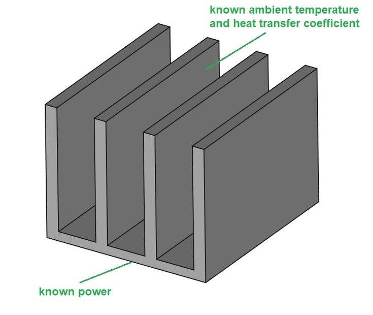

How to calculate a temperature at a base surface of a straight fin heat sink?
Hi,
I've checked the literature but couldn't find any formulas or examples for this particular problem involving heat sink with straight fins:
As you can see, I want to assume:
- power at the bottom surface
- convection (known ambient temperature and heat transfer coefficient) at the remaining surfaces
and calculate the temperature at the bottom surface (which should be lower than in the case when the plate has no fins).
All the formulas and examples that I've found are for different boundary conditions - know temperature or convection conditions at the bottom surface and solving for total heat flux. Here are such formulas for the case with the known temperature at the bottom surface (source: old Polish book "Heat transfer and heat exchangers" by Pudlik):
- heat dissipated from each fin: $$Q_{f}=\frac{\alpha U}{m} \cdot \left( T_{s} - T_{a} \right) \cdot tanh(mL)$$ where: ##\alpha## - heat transfer coefficient, ##U## - circumference of the fin's cross-section, ##m=\sqrt{\frac{\alpha U}{\lambda A_{f}}}##, ##T_{s}## - temperature of the bottom surface, ##T_{a}## - ambient temperature, ##\lambda## - thermal conductivity, ##A_{f}## - area of the fin's cross-section.
- heat dissipated from each surface between fins: $$Q_{bf}=\alpha A \cdot \left( T_{s} - T_{a} \right)$$ where: ##A## - area of the surface between fins
- total heat flux: $$Q_{t}=n_{f} \cdot Q_{f}+n_{bf} \cdot Q_{bf}$$ where: ##n_{f}## - number of fins, ##n_{bf}## - number of surfaces between fins
This way it's possible to calculate total heat flux but how can I obtain the temperature at the bottom surface and how to replace the known temperature of the bottom surface with the known power ? Do you think that the formulas above account for all the surfaces involved in convection (all the existing surfaces apart from the bottom one) or some are omitted ?

The picture attached to my initial post is a screenshot of the 3D model used for simulation so proportions are correct. Of course I can also provide the dimensions.

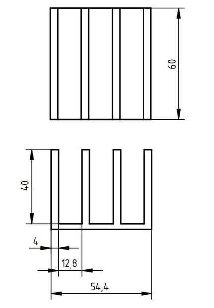

Here are the dimensions:
- fin's width: ##4 \ mm##
- fin's depth: ##60 \ mm##
- fin's height: ##40 \ mm##
- distance between the fins: ##12.8 \ mm##
- base surface area: ##54.4 \cdot 60=3264 \ mm^{2}##

What these results are telling us is that most of the entering heat leaves through the fins, and most of the heat that enters through the web between the fins flows horizontally to the fins. Only a small fraction is flowing into the air above the web. This means that the web is going to be approximately the same temperature as the base of the fins, and that your original equations in post #1 are going to be the correct ones to use, with Ts=Ts'. So try the problem again using these equations and see what you get. The heat load at the base is going to be equal to the sum of the two heats from the two equations.

Thank you very much, now the result makes much more sense. I got ##Q_{t}=80 \ W## for ##T_{s}=258^{\circ}C## while the value from simulation (maximum temperature at the base) is ##244^{\circ}C## when ##80 \ W## are applied to the base. Here are my calculations: $$Q_{f}=\frac{\alpha U}{\sqrt{\frac{\alpha U}{\lambda A_{f}}}} \cdot \left( T_{s} - T_{a} \right) \cdot tanh \left( \sqrt{\frac{\alpha U}{\lambda A_{f}}} L \right)$$ $$Q_{f}=\frac{15 \cdot 0.128}{\sqrt{\frac{15 \cdot 0.128}{237 \cdot 0.00024}}} \cdot \left( 258 - 20 \right) \cdot tanh \left( \sqrt{\frac{15 \cdot 0.128}{237 \cdot 0.00024}} 0.04 \right)=17.9563 \ W$$ $$Q_{bf}=\alpha A \cdot \left( T_{s} - T_{a} \right)=15 \cdot 0.000768 \cdot \left( 258 - 20 \right)=2.7418 \ W$$ $$Q_{t}=n_{f} \cdot Q_{f} + n_{bf} \cdot Q_{bf}=4 \cdot 17.9563 + 3 \cdot 2.7418=80.0505 \ W$$ I wonder if there is a way to increse the accuracy of these hand calculations. The approach used here is approximate but maybe there's no better analytical method.
