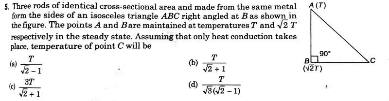

Heat transfer. Could anyone explain the solution?
In summary, the conversation discusses a solved question about the equality of heat flow rates and the calculation of steady-state temperatures. The problem assumes only conduction and no radiated losses. It is concluded that H1 must equal H2 because of the direction of heat flow.
strider171
This is a solved question. The answer is given above.
I can't understand why h1=h2.
[/B]

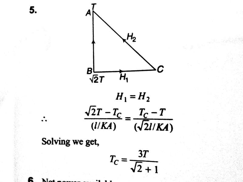

Assume that ##T_C## is between ##T_A## and ##T_B## and that there are equal heat flow rates ##B \rightarrow C## and ##C \rightarrow A## (because we want to calculate steady-state temperatures, and without the equality of the rates the ##T_C## would be changing).
Likes strider171
H = heat flow. Heat H1 flows down B->C. The problem says to assume only conduction (eg through the rods) no radiated losses so where else can that heat flow go if not down C->A ? Therefore H1=H2.
Likes strider171 and Chestermiller
Okay. Got it now. Thanks guys
