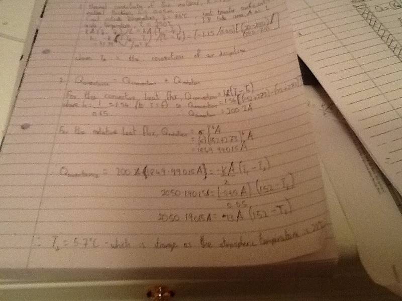

I've broken physics or done the calcs wrong -my final temperature is cooler than the ambient temperature! (5.7) -more likely the latter. Any help would be much appreciated!
-Leo
I am very sorry, but I cannot read most of what is written there.
guppygould said:
View attachment 56877I've broken physics or done the calcs wrong -my final temperature is cooler than the ambient temperature! (5.7) -more likely the latter. Any help would be much appreciated!
-Leo
Well, like voko I can't see it all, but, at the very least, it should be T - 152, not 152 - T in your equation.
I can't see why you can't write out what you did, even if you have an I pad. What's the problem?
Chet
P.S. If you're asking people for help, it's only common courtesy to present what you did in a way so that they can easily read it. Otherwise, you are wasting their valuable time.

Incidentally, I calculated the heat flux resulting from convective heat transfer at the front wall to the surroundings, and it came out to be 2600 W/m2. Even without the radiative flux contribution, this would result in a temperature for the rear wall of 200 C higher than the front wall. The radiative flux would only add to this. Incidentally, in calculating the radiative flux, shouldn't you subtract the flux radiating back from the surroundings at 22C?

No. You were right in the first place. You should be using absolute temperature. It should be ((425)^4 - (295)^2)(0.8)σ.

Lets see your work. What did you get for the convective and radiative fluxes?
Did you use T - 152 for calculating the conductive flux instead of 152 = T? Let me guess. You didn't and you got something like -150 C, rather than something like 450 C.
Chet
Radiative heat flux as 17470 & convective heat flux as 2600 and I've tried both ways with the temperatures because I had it in mind from one of your earlier posts. Thanks for all your help and comments CHET I can see I'm probably getting to be a pain now. Is the correct equation for the conductive heat flux Q=-K(deltaT) though?

q = -k (ΔT/Δx)
Also, recheck your radiative flux calculation. It seems too high by a factor of about 10.

And as if by magic I have an answer that looks reasonable, I can't thank you enough for your help CHET!
