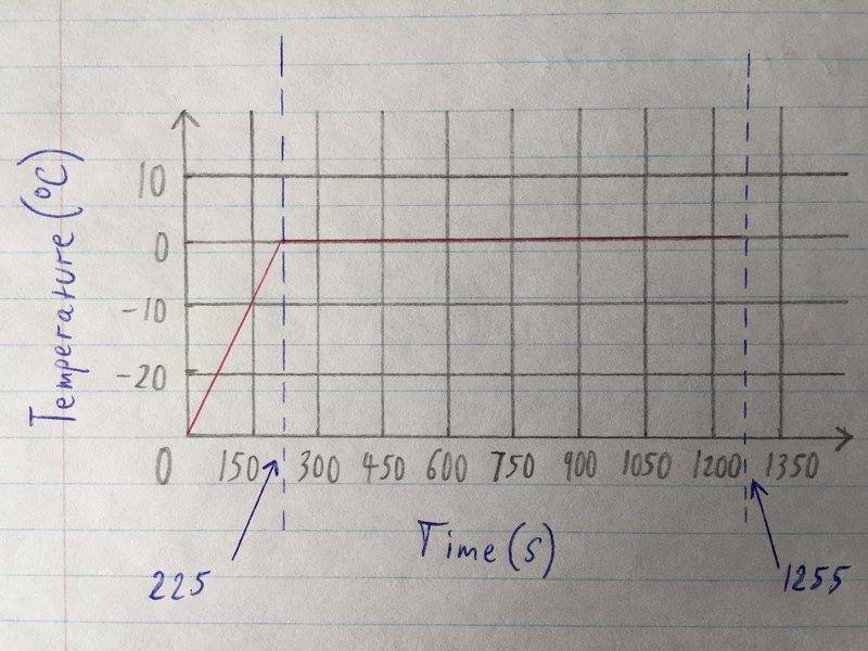

The graph:
Have I done everything correctly? Any confirmation and/or help is greatly appreciated.
I believe the latent heat of fusion of ice is more like 3.34x105Jkg-1. If you round it off to two sig figs then you need to quote fewer in your answer.
Don't you need to include the initial 150s in deciding the end point of the graph?
Other than that, looks fine.

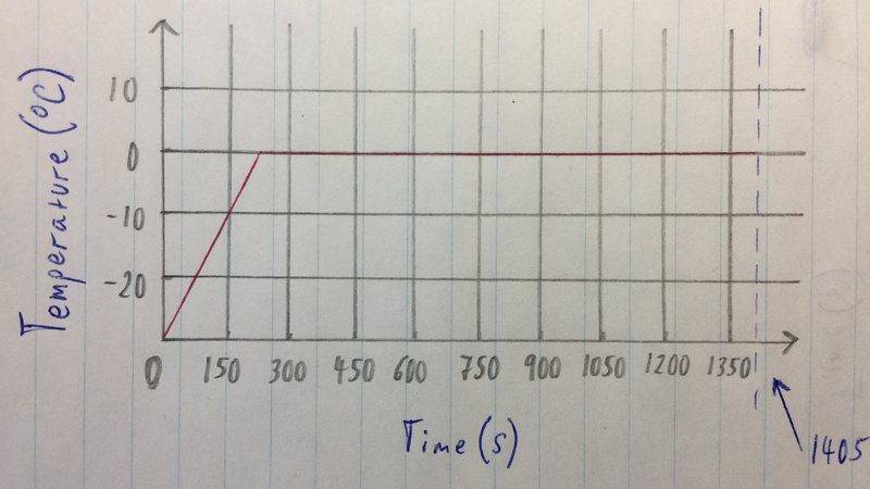

Makes sense, as the question stated from when the ice starts melting...
That would lead to 1255s + 150s = 1405s
Does this look better?
Yes, but as I posted you should either round it off to 1400s or use a more accurate value for the latent heat of fusion (which I think will make it nearly 1420s).

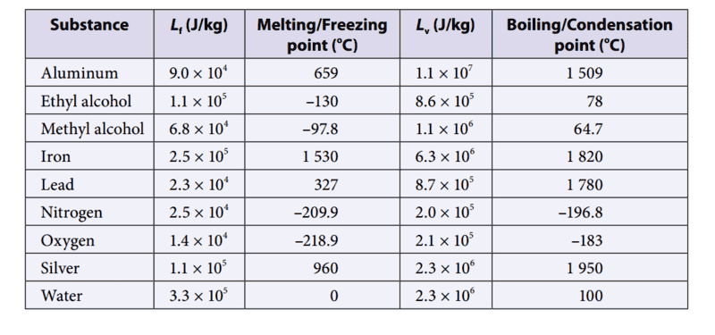

Understood, even though I was following this table in my textbook:
However, I have calculated again using your advice, and rounded up to exactly 1418s in my calculations. I don't think the teacher marking will expect me to know of 3.34 x 105
May I ask from where did you find that info? I could possibly cite the source and write it down with these new calculations, as a justification for my response.
If you are given 3.3 then use that, but it is not given to you as 3.30, so you should only quote two sig figs in the answer: 1400s.
Likes Humbleness
