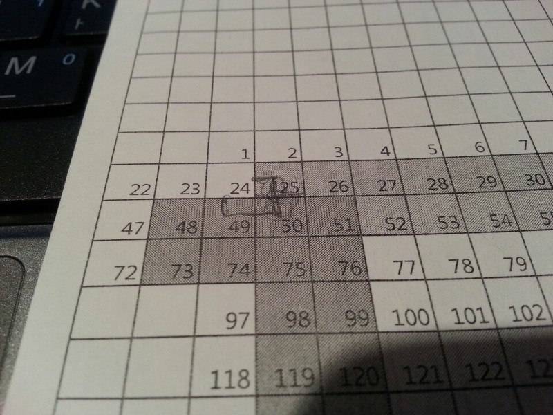

Hello. I'm a student of Univ. of Korea.
As you can see in the attachment, I'm calculating the Temp variation in 2-D.
The node 24 has a convection from left upper quadrant with h, a conduction from right upper with k1 and a conduction from bottoms with k2.
I can't figure out how should I combined those different k values in one Equation...
Thanks..
I think you just add the power coming into 24 through each side.
Which are the lines of constant x and which are the lines of constant y? What is the pde, including the k1 and k2? What is the mathematical expression of the convective BC?
