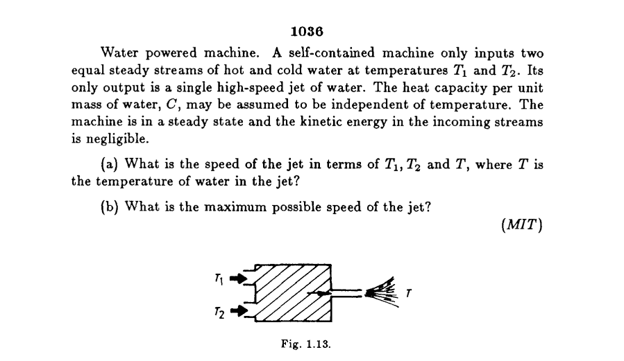

What is the speed of the jet in terms of T1,TZ and T
delta Q = mC delta T
or
delta Q = c delta T , where c is specific heat capacity

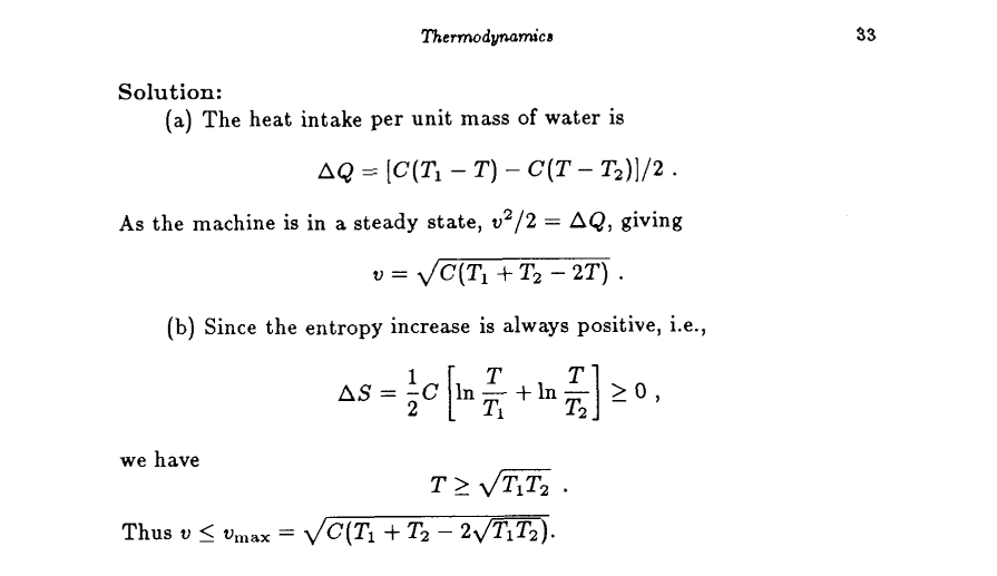

In answering questions (a.) Why heat intake in this system is
## \Delta Q_{sys} = ( \Delta Q_{hot water} + \Delta Q_{cold water} ) / 2 ##
where.
##\Delta Q_{hot water} = c(T_1 - T_f) ##
##\Delta Q_{cold water} = c(T_2 - T_f) ##
I think T or T_f should be between T_1 and T_2
But why is the ##\Delta Q_{sys}## multiplied by a factor of 1/2?

Homework Statement:: What is the speed of the jet in terms of T1,TZ and T
Relevant Equations:: delta Q = mC delta T
or
View attachment 278264View attachment 278265
where.

I think the textbook solution is correct but unclear. The logic gets ‘muddied’ by the fact that ##c(T_1-T)## and ##c(T-T_2)## are both energy per kg.
If ##c(T_1-T) > c(T-T_2)## then ##c(T_1-T) – c(T-T_2)## is the energy available to do work on ***two (not one)*** kg of water (1kg of hot water mixed with 1kg of cold water). So half this amount is the energy available to do work on 1kg of water. That's where the factor of ½ comes from.
I’d present the the solution slightly differently:
Say m kg of hot water and m kg of cold water are mixed, Then 2m kg of water comes out of the jet. We can write directly:
##mc(T_1-T) - mc(T-T_2) = ½(2m)v^2##
which gives the required speed without worrying about the factor ½.

The way I would formulate the open system version of the 1st law of thermo for this mixer would be (per unit mass of flow through the mixer), $$\Delta \left(h+\frac{v^2}{2}\right)=0$$where $$\Delta h=\frac{C(T-T_1)+C(T-T_2)}{2}$$ and where the inlet velocity is essentially zero. The open system version of the 2nd law, per unit mass of flow through the mixer would be: $$\Delta s=\frac{C\ln{(T/T_1)}+C\ln{(T/T_2)}}{2}=\sigma$$where ##\sigma## is the entropy generated per unit mass of fluid passing through the adiabatic mixer. So we would have $$T=\sqrt{T_1T_2}\exp{\left(\frac{2\sigma}{C}\right)}$$So we would have $$v^2=C\left(T_1+T_2-2\sqrt{T_1T_2}\exp{\left(\frac{2\sigma}{C}\right)}\right)$$The upper bound to v would be if ##\sigma=0##, in which case $$v=\sqrt{C}\ |\sqrt{T_1}-\sqrt{T_2}\ |$$

I will note that my interpretation explains the textbook solution and gives the required answer:
##½(2m)v^2 = mc(T_1-T) – mc(T-T_2)##
##v = \sqrt{c(T_1-T) – c(T-T_2)} = \sqrt{c(T_1 + T_2-2T)}##
