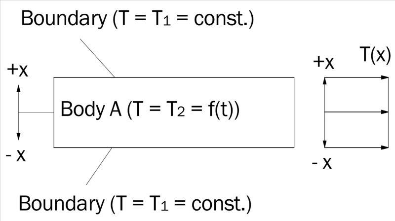

Are the boundaries and the temperature distribution of the Body A you want to assume like in the atttached schematic (for a specific time)?

There are no boundaries of body A, yes that is my assumption.

So, if you are including heat conduction, then are you solving the transient heat conduction equation within body A:
$$\rho C\frac{\partial T}{\partial t}=k\frac{\partial ^2 T}{\partial y^2}$$
where ##\rho## is the density of body A, C is its heat capacity, k is its thermal conductivity, and y is vertical position?
Fritiofmikael said:
@stockzahn
Thank you for your reply,
If the temperature of the bodies B and C is constant you can assume them to be a boundary with ##T= const.## (a so-called Dirichlet boundary condition). You don't need to model them. So to be sure the only temperature changing (only in time) is the temperature of body A?
