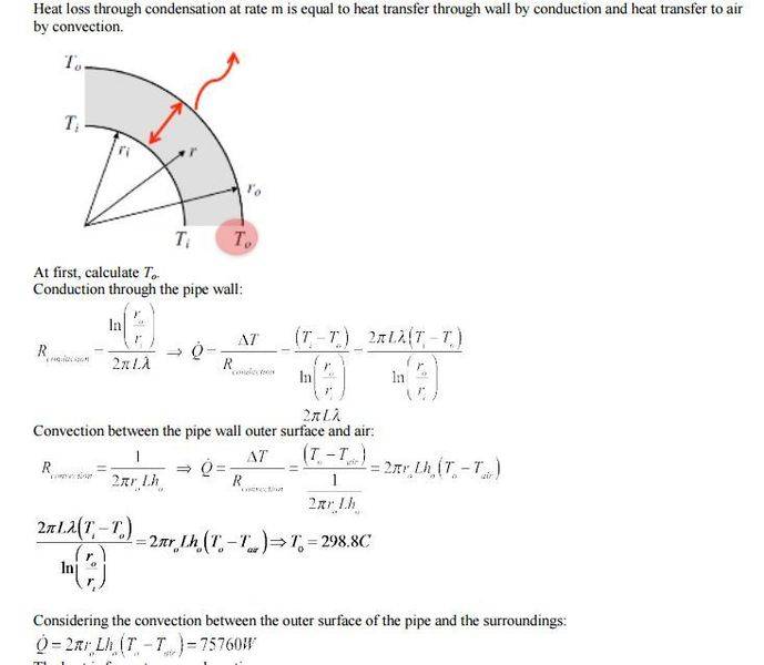

Actually you can use that method (adding up individual resistances) and you will get the same result. I guess the question requires you to find the temperature of the outer surface of the pipe hence employ this method.
Likes williamcarter
Does this mean that Qtotal=Qconvection? We neglect Qconduction ?
They were asking for Q emerging from pipe
If I do like them as Q from pipe =Qconvection=75760 W
if I do like Q=delta T/Rtotal , where Rtotal=Rconduction+Rconvection it gives me Q=75758 W

I do not understand why we need to find Toutside by equating Qcond=Qconv?
And why we need to calculate Q from the pipe just as Qconvection instead of Q total?
Does all the heat flow (Q total) pass through the tube wall?
Does all the heat flow then pass through the convective boundary layer?
So, is Qcond = Qconv = Q total (or not)?
Likes williamcarter
Heat is transferred firstly by conduction within the pipe , then by convection from pipe surface to the air.
To answer the questions I would say , yes Qtotal passes through tube wall, yes Qtotal passes through boundary layer.
There is no insulation at the moment, furthermore no generation,no accumulation so I would say Qtotal=Qconduction=Qconvection
Good. So in part (a), for conduction through the pipe, we have:
$$Q=2\pi kL\frac{(300-T_0)}{\ln{(r_{out}/r_{in})}}$$
and for conduction through the convective boundary layer, we have:
$$Q=2\pi r_{out}hL(T_0-5)$$where ##T_0## is the temperature at the outer surface of the pipe. If we solve for the temperature differences, we obtain:
$$(300-T_0)=\frac{\ln{(r_{out}/r_{in})}}{2\pi kL}Q$$
$$(T_0-5)=\frac{1}{2\pi r_{out}hL}Q$$
So, you have two equations in the two unknowns, ##T_0## and Q. If you add these two equations together, you can eliminate ##T_0## to obtain:
$$(300-5)=\left[\frac{\ln{(r_{out}/r_{in})}}{2\pi kL}+\frac{1}{2\pi r_{out}hL}\right]Q$$
You can then solve this equation for Q and substitute back into either of the other equations to get ##T_0##.
Now, when you add the insulation layer in part (b), you end up with three equations in three unknowns, Q and the two unknown temperatures at the two interfaces. You set up and solve these three equations in basically the same way as part (a). Questions?
