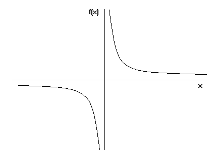

I am not sure how to do this. I mean, plotting the 1/T as a function of T is just plotting the graph f(x) = 1/x which looks like this:
but I am not sure how to put on this graph the entropy calculations we did.

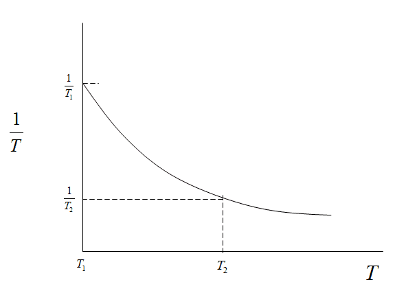

The figure below shows a schematic plot of 1/T vs T. Shown on the T axis are the values of ##T_1## and ##T_2##. Also shown on the plot are the value of 1/T at ##T_1## and ##T_2##, namely, ##1/T_1## and ##1/T_2##.

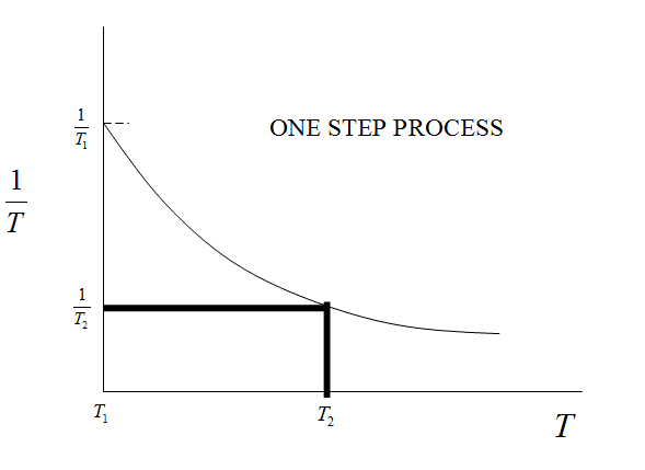

Now let's see how this relates to the 1 step process and the 2 step process. Let's first consider the graph for the 1 step process. This is shown in the figure below:
The area of the rectangle in the figure is ##\frac{T_2-T_1}{T_2}##. Compare that with the temperature term for the entropy change of the reservoir in my post #7 for the 1 step process. The two are identical. So the area under the thick black curve in the figure is identical to the temperature term in the equation for the entropy change of the reservoir in the 1 step process. Next, let's consider the graph for the 2 step process. This is shown in the figure below.

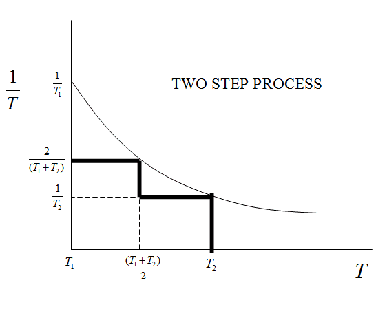

The area under the thick black curve in this figure is equal to ##\frac{T_2-T_1}{2}\left(\frac{1}{T_2}+\frac{2}{(T_1+T_2)}\right)##. Compare this with the temperature terms in your equations for the entropy changes of the two reservoirs in post #8. The two are identical. So the area under the thick black curve in the figure is identical to the temperature term in the equation for the entropy change of the reservoirs in the 2 step process.
Can you see where the area under the thick black curve in the figure for the 2 step process is a better approximation to the area under the curve of 1/T vs T (i.e., the integral of dT/T) than the area under the thick black curve in the figure for the 1 step process? Can you visualize what would happen graphically as we added more reservoirs and steps to the process?
Hello Chet,
I understand the graphs you provided thanks. I see where it is going: as we add more and more reservoirs in the process the area consisting of rectangles under the curve will get better and better at approximating the are under the cure of 1/T vs T.
So in the limiting case (where number of reservoirs goes to infinity) this would then become what we call a quasi-static process and we will have matching between these areas.
I suppose that total entropy change in this limiting case should then be zero?
Also I wanted to ask why did you use 1/T vs T graph, what is the physical meaning behind using 1/T?
Thanks for the effort of explaining this to me, I really appreciate it!
