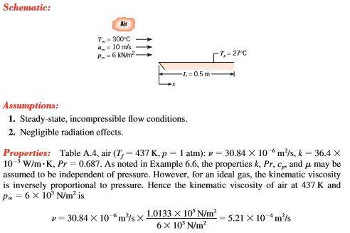

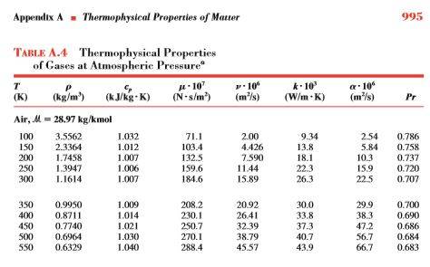

1. How did they decide on the temperature 437K to use in the table.
2. And why is the viscosity 10^-6? Not 10^6?

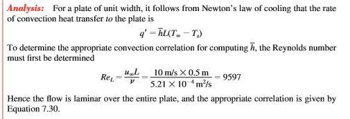

4.Last question is on the 3rd image it shows the Reynolds number is ~9000, isn't that a turbulent flow, but they say its laminar? According to wikipedia laminar flow is less than 2000 correct?
I have no idea. Maybe they meant 200 C in the problem statement insteady of 200 C, in which case the temperature would be 473K.
Look at the heading at the top of the column. It says ##10^6\nu##. That means that each of the numbers in the table has been obtained by multiplying the actual ##\nu## value by ##10^6##
3. I see that the description mentions something about the inverse viscosity, can anyone elaborate a little about that?
It says that the kinematic viscosity of a gas is inversely proportional to the pressure. Do you know what this means mathematically? What pressure do the values in the table apply to?
The laminar-turbulent transition depends on the specific geometry. The value of 2000 corresponds to flow in a tube. The critical Re for flow over a flat plate is much larger. Why don't you research it an get back with us?
Well viscosity increases with an increase in pressure. Based on the equation for kinematic viscosity, kviscosity=viscosity/density, if viscosity and pressure are both increasing, shouldn't the kinematic viscosity be increasing as well?
OK got it, pretty simple. Re for turbulent flow over a flat plate is 10^8.
weeman203 said:
Thanks for the help!
For an ideal gas (and for real gases at low pressures), viscosity is independent of pressure (see Transport Phenomena, Bird, Stewart, and Lightfoot, Chapter 1) and density is proportional to pressure. So kinematic viscosity is inversely proportional to pressure.
Likes weeman203
In analyzing the convection heat transfer over a plate you should have the "reference temperature" to look up, or calculate, the fluid properties such as viscosity, density, and also the thermal conductivity. Here they choose the "film temperature" to be the reference, and the film temperature is defined as the arithmetic mean of fluid temperature (573K) and the contact surface temperature (isotherm at 300K).
(573K + 300K) / 2 should yield 436.5K ~ 437K just to ignore the decimal digit.
The properties need to be evaluated at an average film temperature to approximate the heat transfer coefficient. They based their calculation on the arithmetic average film temperature. It's a judgment call.
