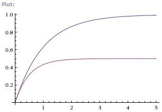

(d) The main difference I see is in the limiting concentration in the leaf, that is the concentration as $t\to\infty$:
For the model in part (b), we have:
\(\displaystyle \lim_{t\to\infty}C(t)=C_a\)
And for the model in part (c), we have:
\(\displaystyle \lim_{t\to\infty}C(t)=\frac{\alpha C_a}{\alpha+\beta}\)
Notice if \(\displaystyle \beta=0\), then the two models are equivalent, as we should expect.
Another difference is that the second model approaches its limiting value more rapidly, since the herbicide is being dispersed, or removed from the leaf, resulting in a slower rate of change. Here is a plot of two possible curves, letting $C_a=\alpha=\beta=1$:
