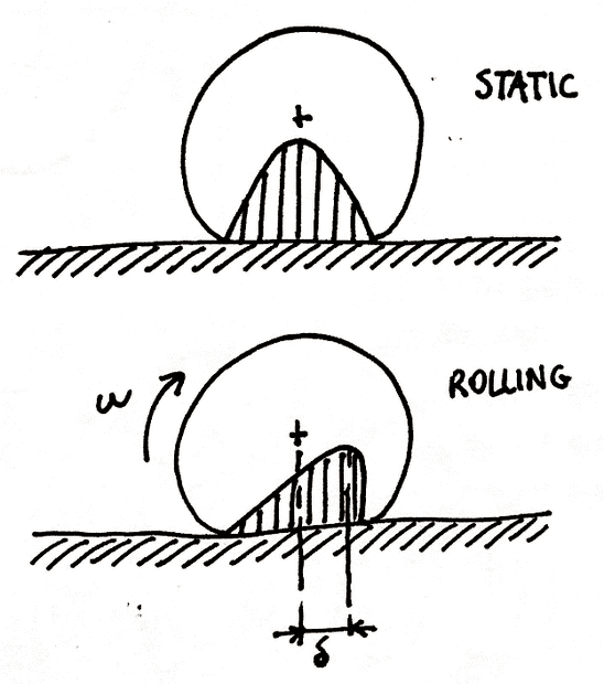

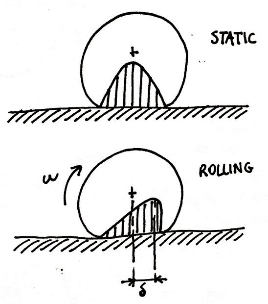

The contact patch of the tire on the slightly convex road has a different area and shape than when not in contact. This repetitive "squirming" causes various heating mechanisms of the rubber.

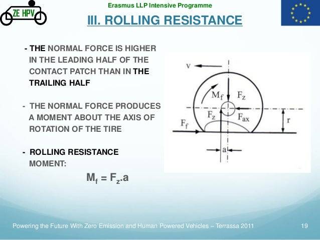

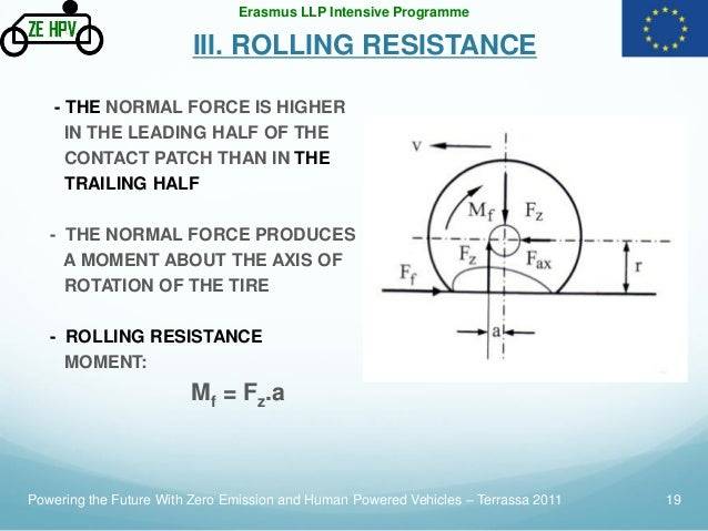

Rolling resistance has nothing to do with friction. It is a moment due to the misalignment of the normal force acting at the axle vs the one acting at the contact patch.
Indeed, this is correct.

But the main source of heat is the constant deformation of the tire and it can be evaluated by a moment, not by some friction coefficient and normal force.

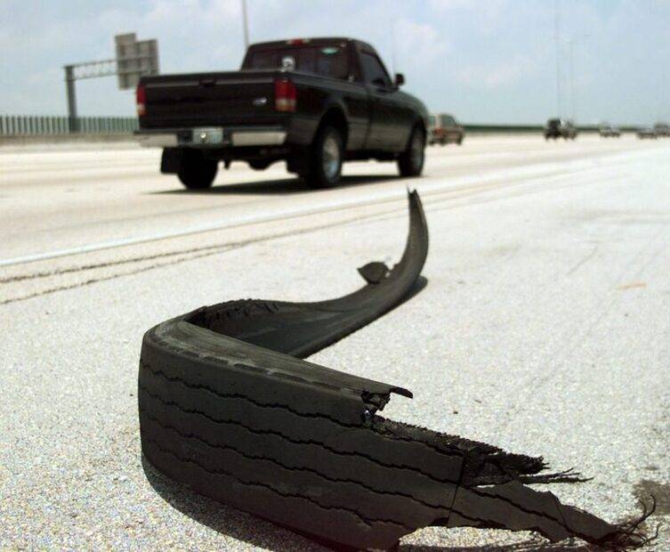

Internal friction of tube against carcass, or even inside delaminating plies of a damaged carcasse, also increases temperature of the tire.
A normal tire can become very hot (to the point of destruction) simply by underinflation combined with high static (weight) and dynamic (speed associated) loads.
